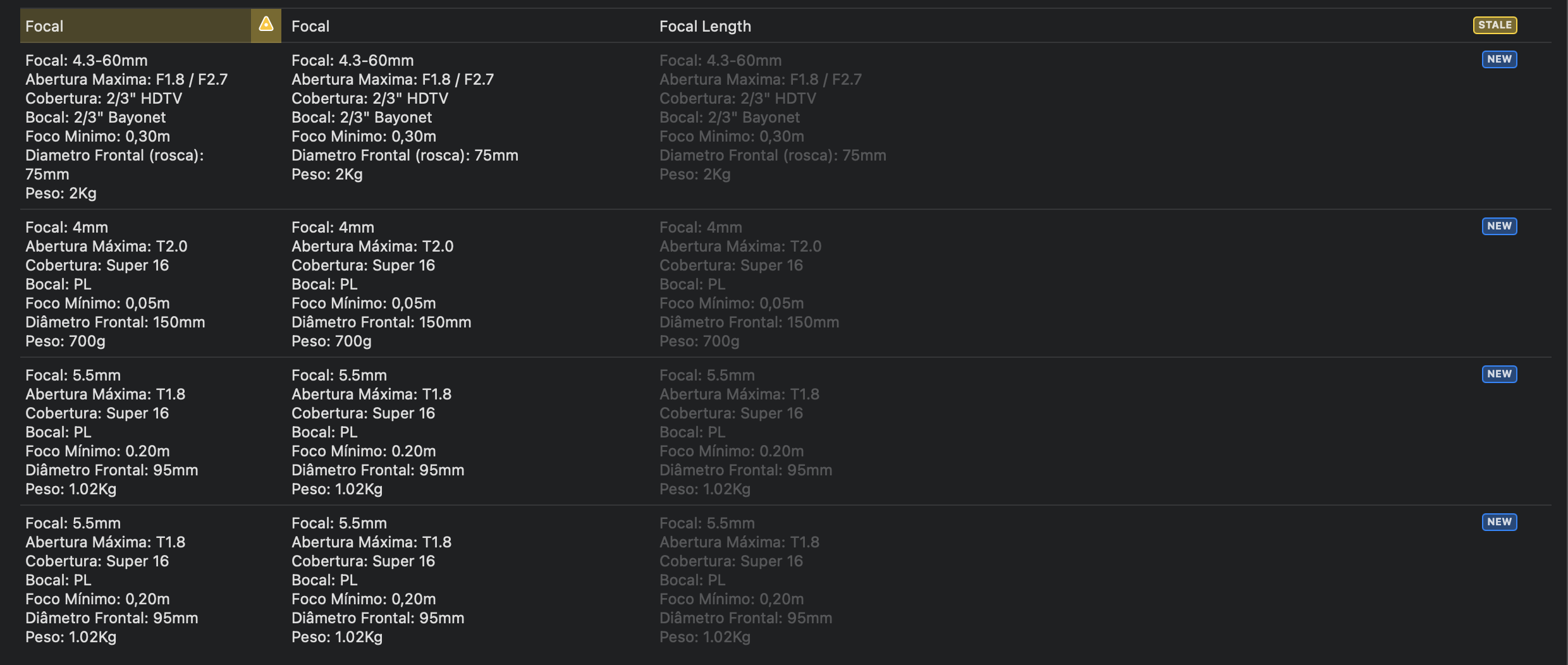

Thanks so much for the help. It kind of worked but the string catalog brought all the description as localizable. I just want these strings to be localizable
Focal, Abertura Maxima, Bocal, Cobertura, Diametro frontal, Peso, Foco Minimo
Is there a way to do that?
For now the only thing I added was:
class LensStructFilter: Identifiable {
    var description: LocalizedStringResource
    init(description: LocalizedStringResource) {
        self.description = description
See screen attached. :
