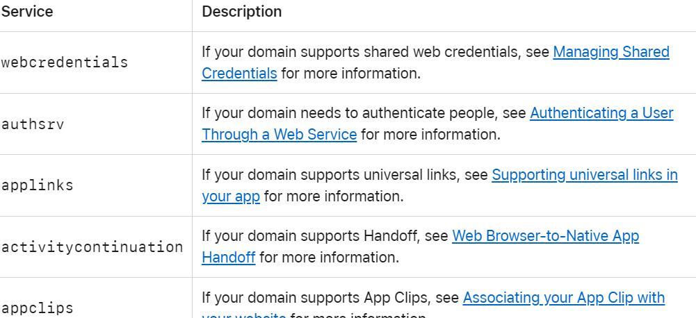

Thank you very much for your reply! Since I am not a specialist in the Apple domain I have struggled to understand our options to be able to provide SSO between the apps. From your reply It looks Associated domains will not achieve our goal so we will look into the two options you have provided.
One question though that has bothered us, and something you might be able to clarify for us: When setting up the “Associated domains capability” there is specific service called "authsrv" that can be specified which implies a pointer to an authentication service in the domain. What is the purpose then of being able to define this service as an “Associated domains capability”?
