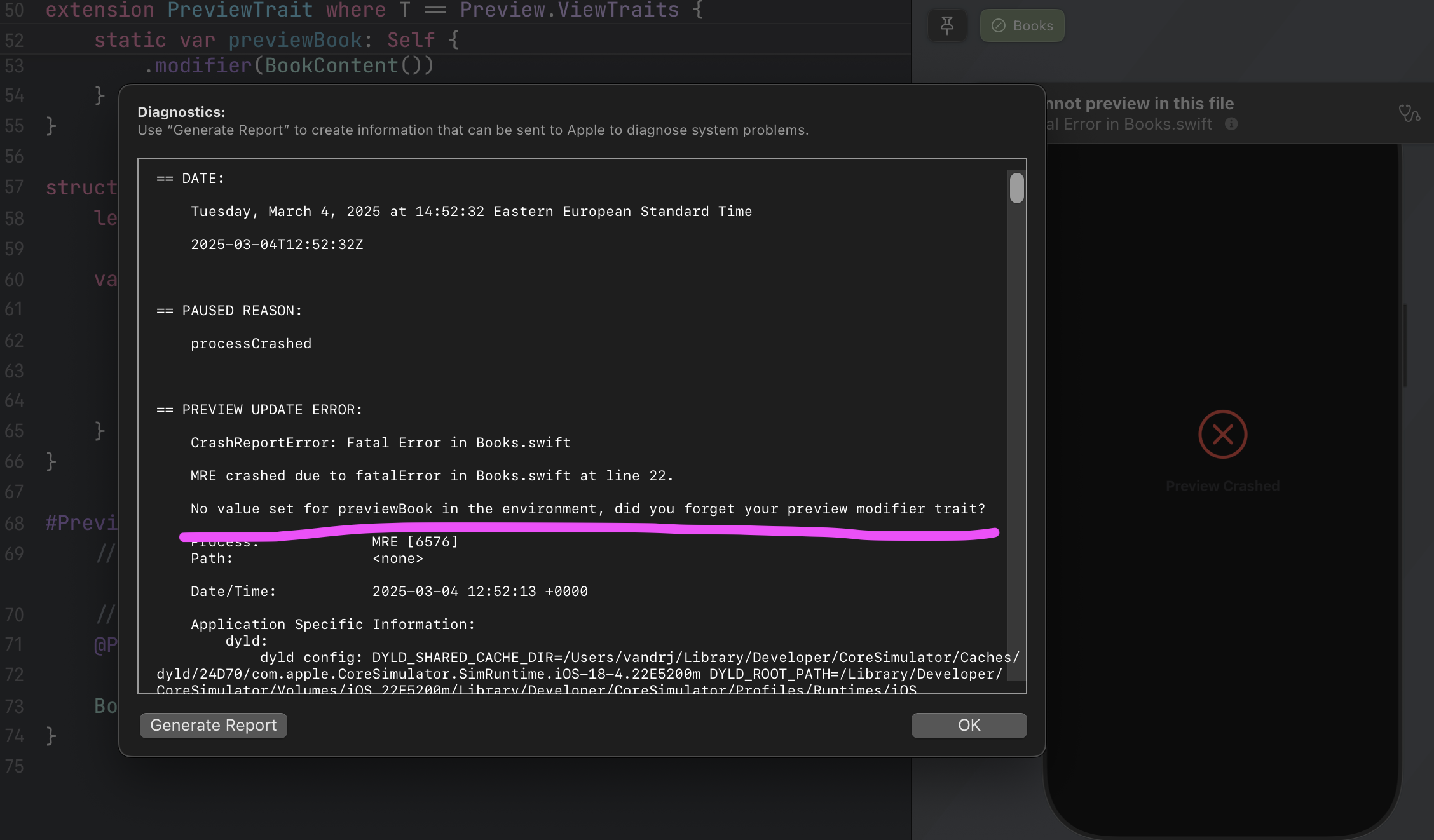

@Developer Tools Engineer , you are giving a bad example because this will lead to a crash:

@VAndrJ you are correct that the default value will cause a crash in the case where Book is not in the SwiftUI environment. However, if this environment value is only for use in your previews and you always set the preview trait when needed in those previews, it seems like having a crash with a helpful message to inform you that you forgot is desirable.
Having said that, wrapping this code and the related preview modifier / previews in #if DEBUG or some similar flag in your project to ensure that usage of it does not reach your production app would probably be a good idea. You could also remove the fatalError and put in some reasonable default value if that makes sense for your use case.

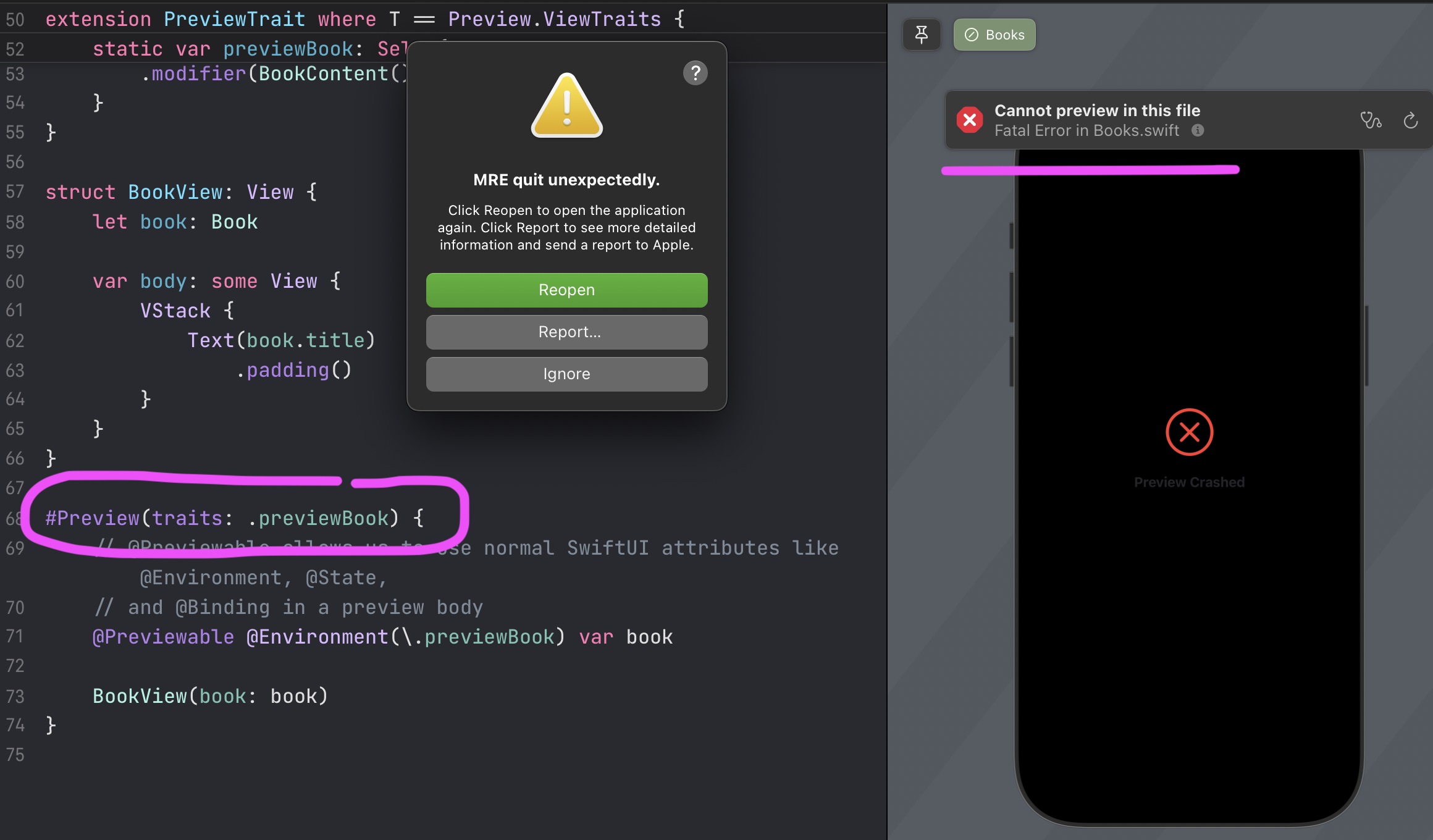

@Developer Tools Engineer it will cause a crash even when Book is in the SwiftUI environment. Because the @Environment value got called multiple times, and some of that calls with a default value.
Here I tried your example in a simplified version and got a crash:

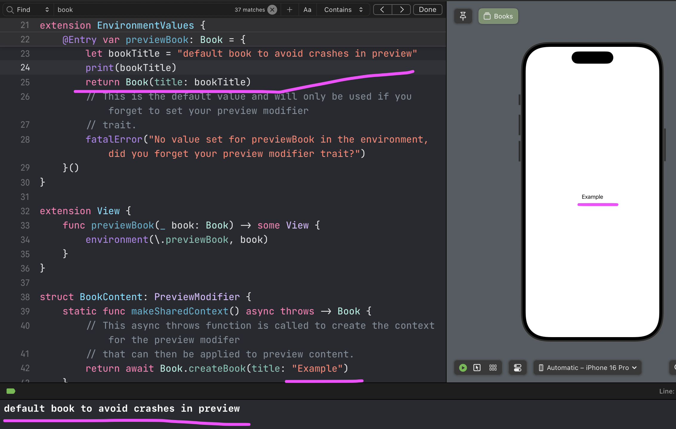

Then I added a default Book and it started to work:
This became especially noticeable when, in Xcode 16.2, the @Entry macro was changed, and it started generating code with a computed property for defaultValue instead of a stored property.
Used code:
struct Book {
    // Interesting properties here...
    let title: String
    static func createBook(title: String) async -> Book {
        // Await the content here...
        // Initialize the Book with actual content...
        return Book(title: title)
extension EnvironmentValues {
    @Entry var previewBook: Book = {
//        let bookTitle = "default book to avoid crashes in preview"
//        print(bookTitle)
//        return Book(title: bookTitle)
        // This is the default value and will only be used if you forget to set your preview modifier
        // trait.
        fatalError("No value set for previewBook in the environment, did you forget your preview modifier trait?")
extension View {
    func previewBook(_ book: Book) -> some View {
        environment(\.previewBook, book)
struct BookContent: PreviewModifier {
    static func makeSharedContext() async throws -> Book {
        // This async throws function is called to create the context for the preview modifer
        // that can then be applied to preview content.
        return await Book.createBook(title: "Example")
    // This is called to modify your preview content with the context created above whenever
    // you apply your preview modifier to a #Preview.
    func body(content: Content, context: Book) -> some View {
        content.previewBook(context)
extension PreviewTrait where T == Preview.ViewTraits {
    // Create a convenience for applying the above preview modifier to a preview
    static var previewBook: Self {
        .modifier(BookContent())
struct BookView: View {
    let book: Book
        VStack {
            Text(book.title)
                .padding()
#Preview(traits: .previewBook) {
    // @Previewable allows us to use normal SwiftUI attributes like @Environment, @State,
    // and @Binding in a preview body
    @Previewable @Environment(\.previewBook) var book
    BookView(book: book)
