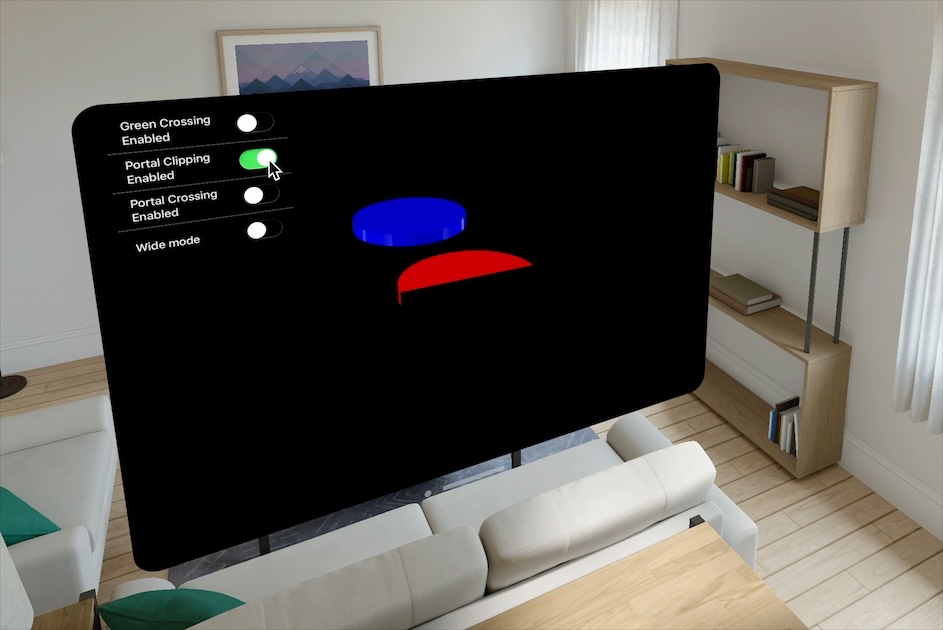

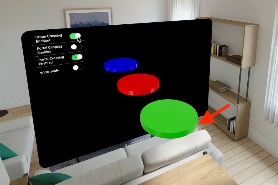

I discovered part of my confusion. An entity (e.g., green cylinder) that is front of the portal is still visible as long as the portal's clipping plane isn't activated.
In screenshots below, initially Red cylinder is at Z = 0; Blue cylinder is at Z = -0.3 Green cylinder is at Z = 0.3 (in front of the portal plane).
Despite the green cylinder being in front of the window/portal plane, it is initially still visible as long as it is positioned between the camera and the portal window.
When I activate the clipping plane, the green cylinder disappears, and the red cylinder gets cut in half.

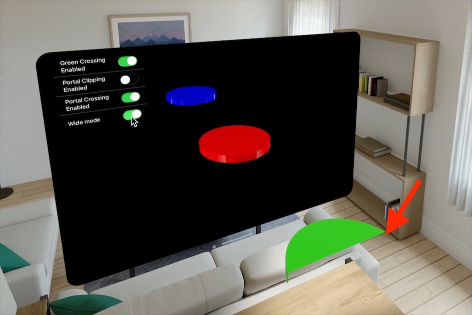

To have the green cylinder appear beyond the frame of the portal, (1) the portal has to have the PortalComponent's crossingMode set to .plane(.positiveZ) and (2) the green cylinder needs to have a PortalCrossingComponent.
I am still stuck on the fact that when I move the green cylinder's Z position to +0.5, it still gets clipped.

Example screenshots:
Green cylinder Z at 0.3, it appears in front of the portal but rendering is still bound by the portal.
Portal's clipping plane is enabled. Green cylinder is gone, and red cylinder is cut in half, verifying clipping plane is at Z = 0.
Portal's PortalComponent crossingMode = .plane(.positiveZ) and PortalCrossingComponent added to green cylinder.
When green cylinder is pushed out to Z = 0.5, part of it is still clipped. Is there a limit for how far things can come out of the portal?
Hi @THeberlein
Thanks so much for sharing your research. I'm certain your post will help others. I believe the green puck is being clipped by the window. Here's how to see the clipping:
  • In debug mode open "Debug Visualizations" by clicking the button to the right of the "step out" button in the "Debug Area" (bottom pane). It kind of looks like a box.
  • Select "Clipping".
  • You'll see the puck is clipped
I'll ask around to see if that can be changed.
Hi @THeberlein
The cause is indeed app clipping. The clipping behavior is not limited to content in a portal, it happens for any/all entities that exceed the app's bounds. I was able to get a little more room using a volume with.windowResizability(.contentMinSize):
WindowGroup {
    PortalView()
        .environment(appModel)
        // It doesn't seem to matter what depth is passed to frame.
        .frame(depth: 2)
.windowStyle(.volumetric)
If you want to avoid clipping entirely, use a plane in an immersive space.
