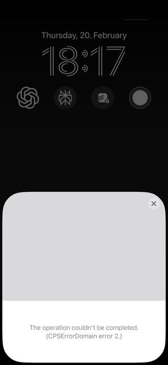

A few days ago scanning NFC tags or QR codes for AppClips with advanced experiences started showing the error "The operation couldn't be completed. (CPSErrorDomain error 2.)" in the AppClip sheet as seen here:
We are providing AppClips to our customers and they trust AppClips to always work, since it is a big part of their business.
Since this is happening at our customers phones and on the phones of their customers, I don't have a sysdiagnose.
I already created a feedback entry about this FB16601674.
We checked everything, our AASA file, the Appstore Experiences.
We had another bug with this AppClip sheet, where it's shown for a split second and then the user is forwarded to the website instead.

@DTS Engineer / Quinn, I was able to reproduce the CPSErrorDomain error 2 while writing a sysdiagnose.
I attached a screenshot and the sysdiagnose file to https://feedbackassistant.apple.com/feedback/16601674

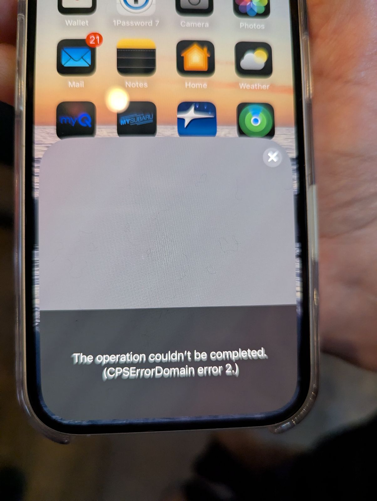

I am facing this exact same issue. App clips have recently become very inconsistent.
Adding +1 that our App Clip has seen "CPSErrorDomain error 2" reported by customers on and off during the last week when invoked by an NFC tag scan. (We haven't released an app update in months.)
I haven't been able to reproduce this locally on one of our test phones, so no sysdiagnose to submit, but I will keep trying.
For most customers, the App Clip is working. But we're inconsistently seeing these other two behaviors:
  • The customer is taken to our website in Safari instead of displaying the App Clip.
  • The App Clip appears, broken, as seen in the attached photo with "CPSErrorDomain error 2".
