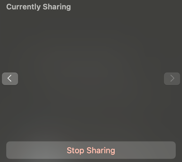

Perhaps this issue might be related to a macOS bug where the system dialog indicates that the screen is being shared, even though nothing is actually being shared. Moreover, when attempting to stop sharing, nothing happens.
