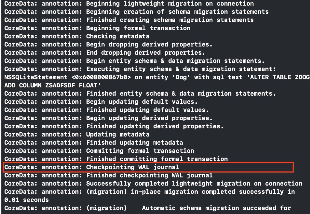

When I enable com.apple.CoreData.MigrationDebug the lightweight migration logs the WAL checkpointing, however, when using NSMigrationManager no such log appears. When I tried inserting 1000 objects, all of them get inserted into the sqlite file. Nothing gets inserted in WAL file. Is the behavior different for NSPersistentCloudKitContainer?

The code path of lightweight migration, which does migration in place, is different from the one of running NSMigrationManager, and so I am not too surprised that the logs are different. If you can provide the logs generated by running NSMigrationManager for me to compare, I will be able to confirm. I'll be very surprised if NSMigrationManager doesn't checkpoint the data though.

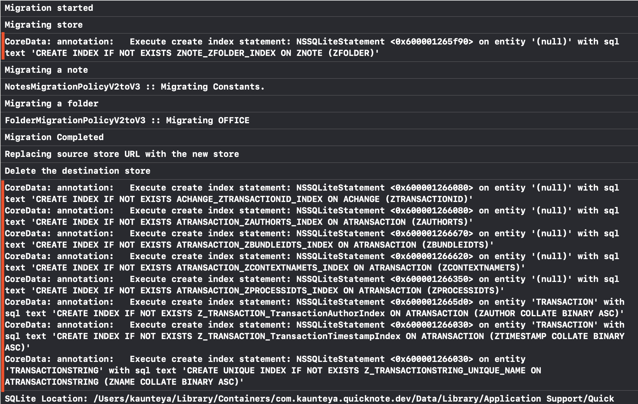

These are the logs when migration happens from NSMigrationManager
@DTS Engineer were you able to check the logs shared above?
I haven't... The new log doesn't unveil the activities in the migration process. To give a definitive answer, I'll need to look into the framework code, which I currently don't have enough bandwidth to do.
Probably an easier approach, you might be able to test the behavior by generating a store with some data in the -wal file using multiple persistent store coordinators and a larger dataset. If you have a chance to do that, I'll be super curious on your conclusion.
I see checkpointing an internal thing in Core Data, and so would be surprised if NSMigrationManager doesn't handle that.
