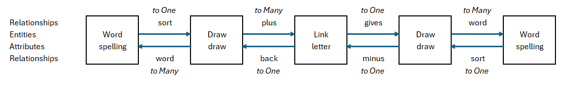

So my data model looks like this:
And here is how I implemented it in Xcode:

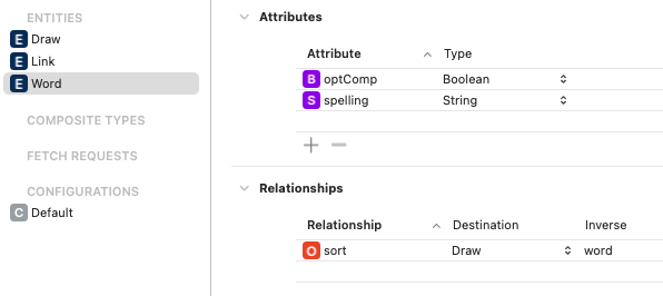

Entity Word
(let's forget the attribute optComp that plays no role here)

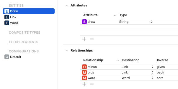

Entity Draw

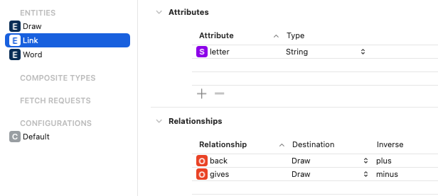

Entity Link

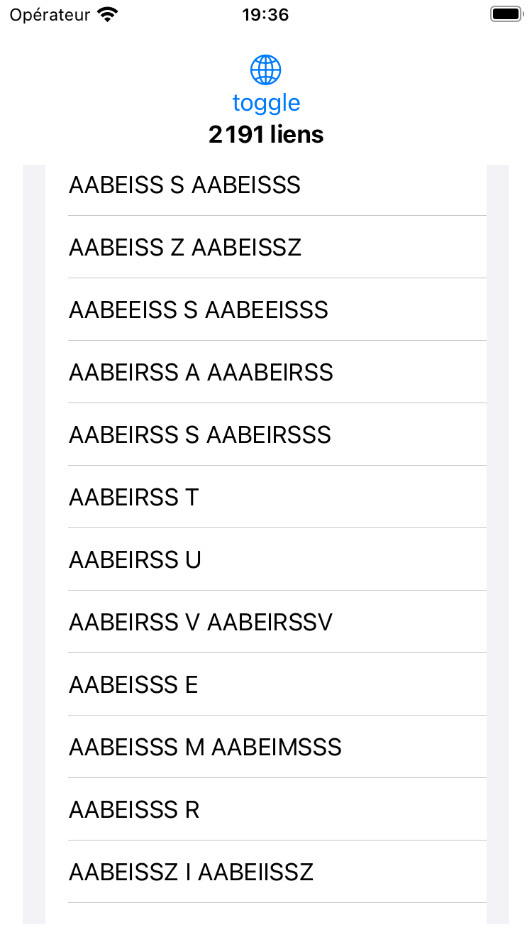

Here is where something goes wrong. If the Link's and the relationship Draw.plus seem to be correctly created, the other relationship Link.gives is only partially populated, say 50%.
Moreover, I tried to apply an additional routine (updateLinks()) , focusing only on Link's with an empty Link.gives relationship and updating them. But again, only 50% of the nil relationships appear to be populated.

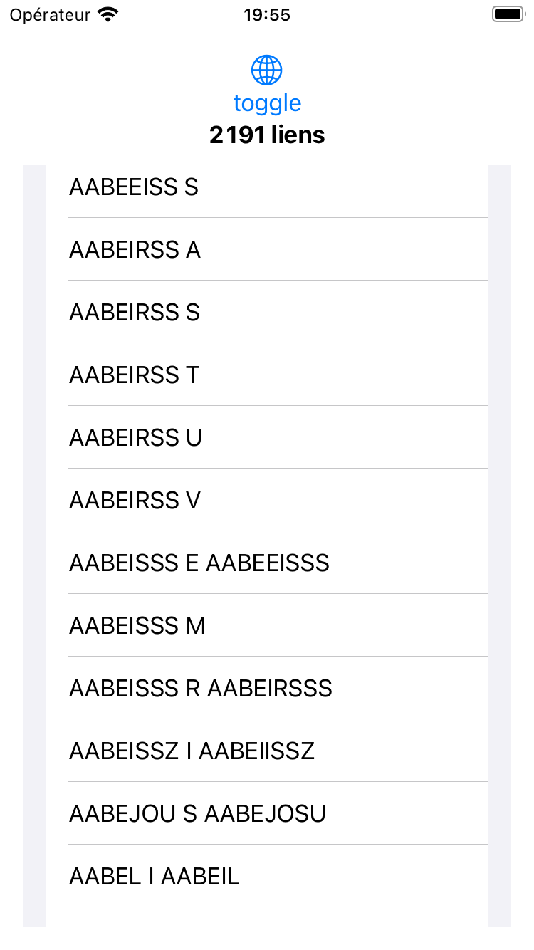

And this is the output showing the content of the Draw entity with relationships after createLinks() is applied:
And here after updateLinks() is applied :

The problem is triggered because Link.gives and Draw.minus are both a to-one relationships, and so when when you connect a draw to link A via linkA.gives and the draw was already connected to link B, linkB.gives will be nullified.

This is an as-designed behavior – When you set a relationship, Core Data automatically sets the inverse relationship to maintain the data integrity.
To fix the issue, Link.gives or Draw.minus or both will need to be a to-many relationship. If that isn't appropriate, you will need a new model that fit your data.
