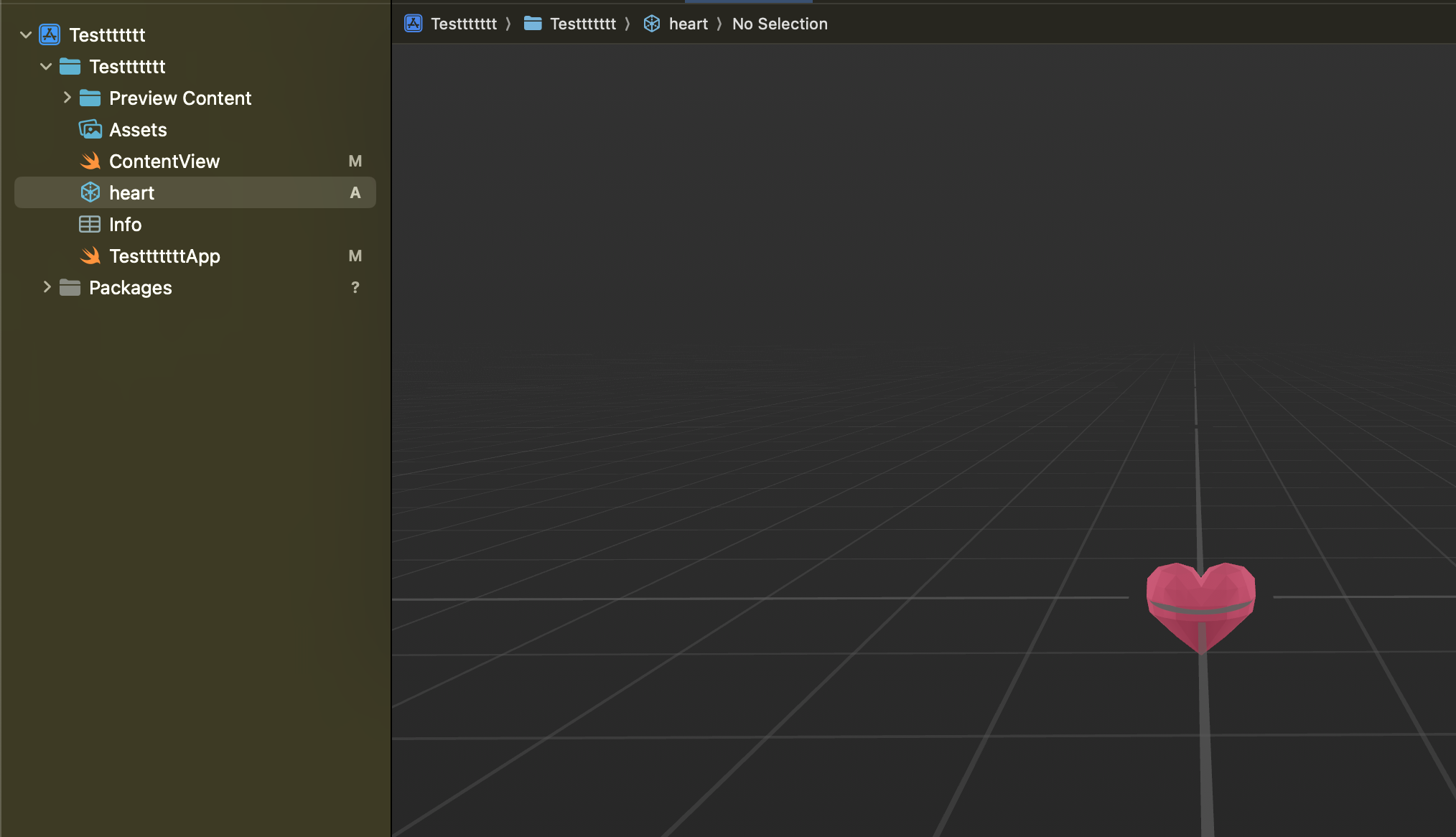

Why can't I load a ModelEntity from RealityKitContentBundle?
If I place the .usdz file in the project directory alongside other .swift files, ModelEntity loads it perfectly. However, if I try to load the same file from Reality Composer Pro under RealityKitContent.rkassets, I get the error: resourceNotFound("heart").
Could someone help me with this? Thank you so much

Hello @WeAreAllSatoshi
My first recommendation would be try using Entity(named: in: ) to see if you can load your asset that way. There are some differences in how ModelEntity(named: in: ) loads model entities from RCP packages and from the main bundle that may be causing the error you're seeing here.
A ModelEntity is, essentially, an Entity with a ModelComponent, so you should be able to find your ModelComponent on the Entity you load with Entity(named: in: ) and access any necessary data that way (even if the root entity is not technically a ModelEntity - the ModelComponent and mesh data should still exist somewhere in the loaded Entity's hierarchy). Can you elaborate a bit more on what you are trying to do with the entity you're loading? I am happy to give suggestions based on your specific context.
