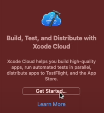

I believe I am meeting requirements. I am using GitHub. and have even tried re-cloning my repo from Xcode. I also tried disabling the the Apple's firewall in System settings. I tried on my personal network and also tried from a cell hotspot. Don't think a firewall is the issue. In documentation under the cloud tab I see that users have this "Get Started" option (see screenshot). I don't think I've ever seen this. In this section when I visit the cloud tab it just says "Loading Products" then eventually times out and says "Could not load Xcode Cloud data"

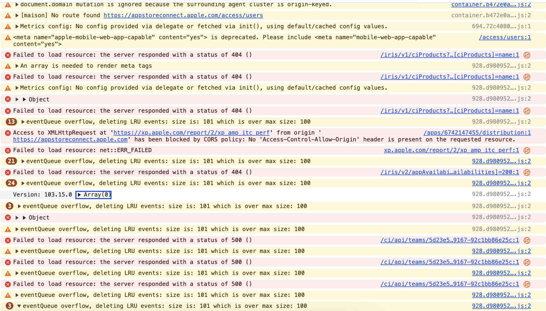

I'm trying to enable XCode Cloud again but I do get a spinner on AppStore Connect > Apps > My App > Xcode Cloud. When inspecting the requests of the website, I can see an API failing with a 500 error so I assume it's just an API failing for some reason and Apple are aware about it.
500
Internal Server Error
https://appstoreconnect.apple.com/ci/api/teams/123123-123123-123123-123123

With more experimentation if I log out of my developer account in Xcode settings then I see the "Get Started" button in the screen shot. However once I log into my developer account I have the problem. Thanks for the feedback since this was my first time messing I spent a stupid amount of time trying to work through it.

The issue is still there for me—I’ve tried so many different things but haven’t had any luck yet. The API keeps returning a 500 error.

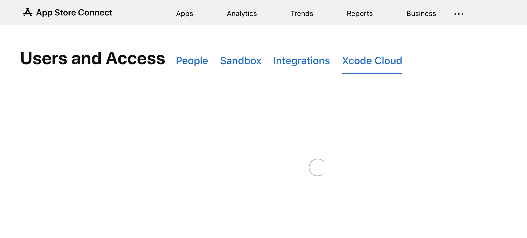

Something else that I did find out is that it looks like this is an issue at the account level and not at the app level as I am getting the same error when I go to "AppStore Connect > Users and Access > Xcode Cloud". The loading spinner doesn't stop as the requests to the same endpoint as failing with a 500 error.
