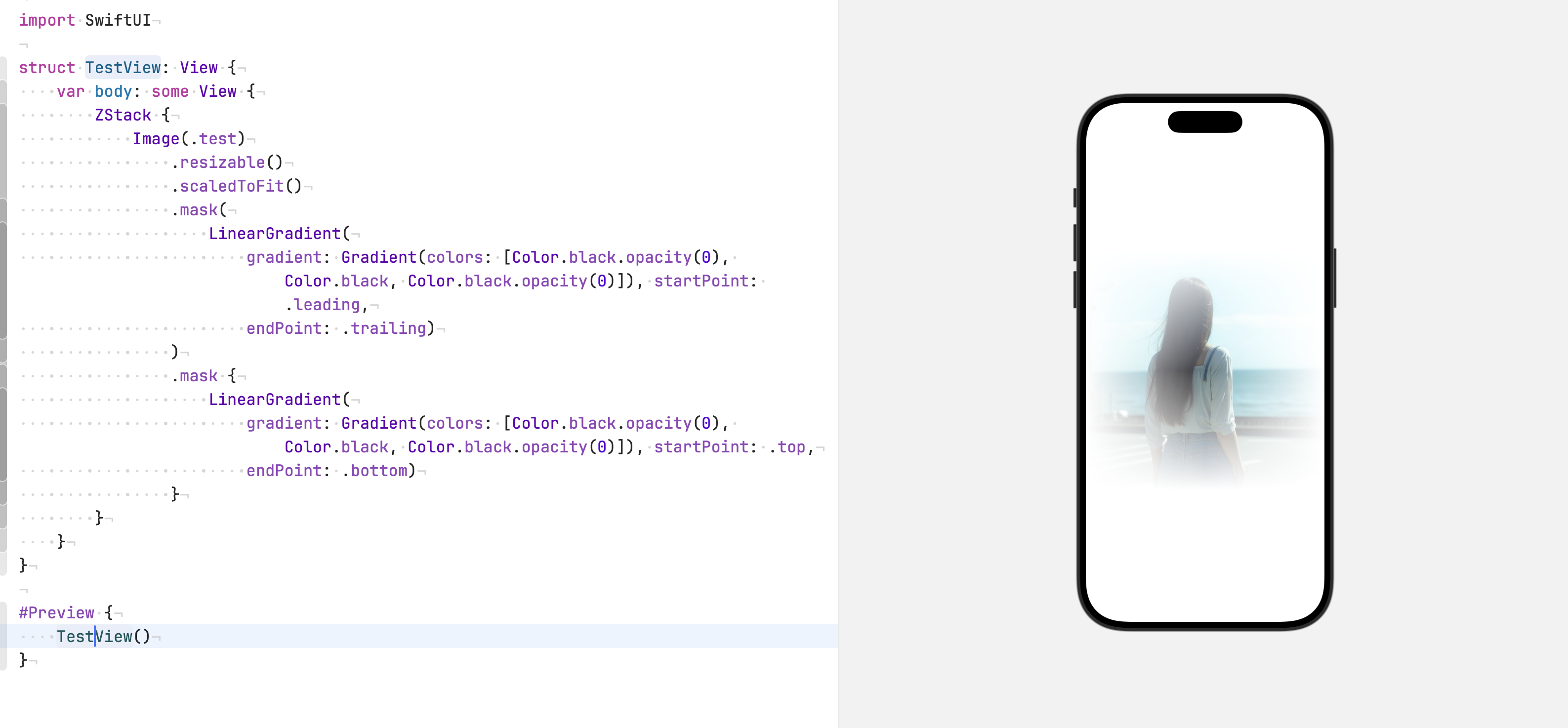

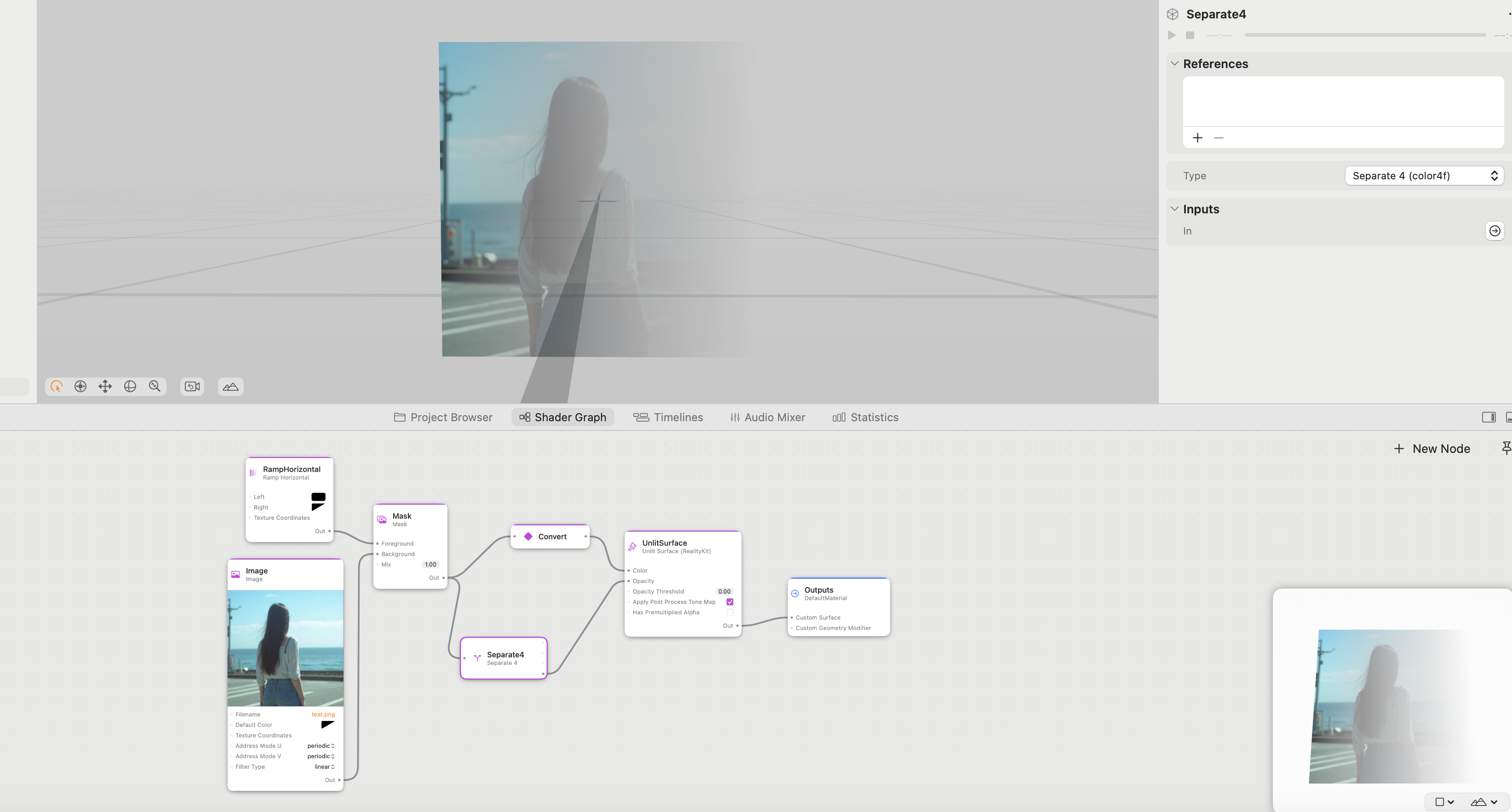

Here is What I have tried. But it seems the right edge is gray.
I have achieved this using SwiftUI. It works great.

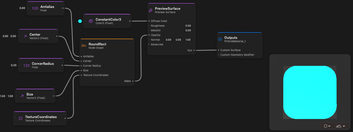

Hi @Vision Pro Engineer this Shader Graph creates a nice gradient. Could you also provide another Shader Graph that applies the same gradient effect within a rounded rectangle mask?
@ahmedg
Hi, thanks for comment. I'm working on a shader graph for cropping an image within custom shapes. I have created the shapes in float but haven’t yet found the way to convert into texture coordinates in Reality Composer. Right now, Im trying to separate (x, y) to generate parts of the shape and then add a gradient, it should be good.
