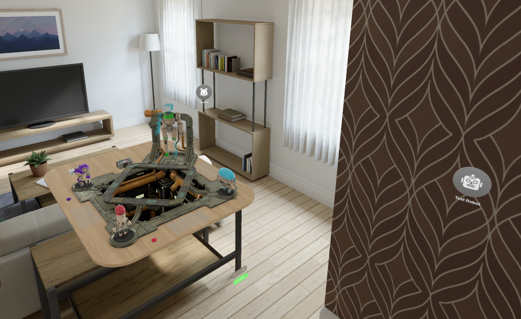

I am currently developing an experimental VisionOS app, to investigate the social effects of the new Spatial Persona feature, for my bachelor thesis. My setup includes a simple board game for the participants, in which they can engage with their persona avatars.
I tried to use the TabletopKit for this setup, but ran into issues when starting the SharePlay session. When I testes my app, I couldn't see the other spatial persona anymore, despite the green SharePlay button indicating the session started. The other person can see my actions in their version of the app on the board, but can not interact with anything. Also, we are both seat on the default side of the seat.
I tried to remove the environment I added, because it doesn't seem to synch with the other player. When I tried the FaceTime feature in the simulator without the environment, I could then see the test robot avatar, but at a totally wrong place. It's seems like it isn't just my environment occluding the seats, but a flaw in the seating process as well.
When I tried the FaceTime feature in the simulator on the official test scene (TabletopKit Sample), I got the same incorrect placement and the warning "role(for:inSeatNumber:): The provided role identifier does not match a role in the current template."

Please provide us with the steps to reproduce the screenshot.

You are right that SharePlay doesn't work entirely on the simulator, however the virtual FaceTime feature allows to create (simulated) spatial persona entities, as seen in the screenshot. Because I originally found the issue while testing on the real hardware, it can't be just caused by the simulator.
Reproduction:
  1. loading the sample project
  2. start the simulator
  3. open a virtual FaceTime call (via ‘features’)
  4. activate the Spatial Persona function for the call via the FaceTime interface
  5. build the example project on the simulator
  6. start the SharePlay session via button
Hey @niklas_prahl
The Spatial Personas feature is not available in the Simulator. What you're seeing is just a person's photo/avatar, which can be set in the Contacts app. Currently, seat placement in TabletopKit is not working correctly in the Simulator—so to get accurate results, you need to test on a real device.
