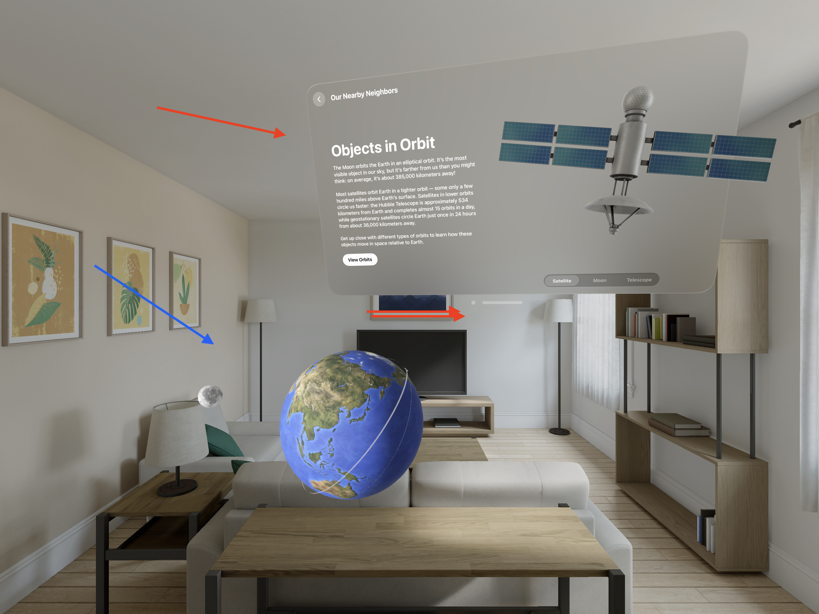

I tried pressing simulator's "Home" button while "Objects in Orbit" immersive space was presented alongside with the main application window. According to user documentation, pressing Digital Crown should take the user directly to Home View. In my test a single press only dismissed the immersive space, I needed another press to "exit" the app and go to Home View.

For some reason the screenshot didn't get attached correctly in the previous message, the red arrow points to what I referred to as the main application window and the blue one points to immersive space content:
