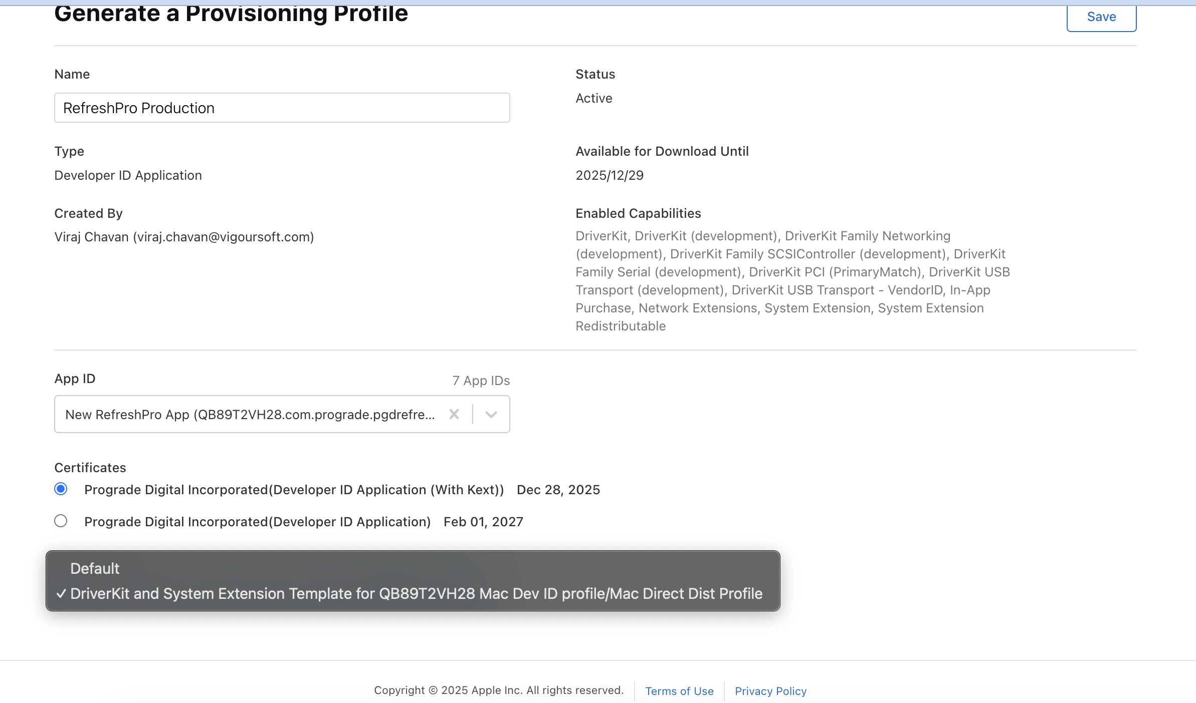

Hi Kevin
We spent some time to create a provisioning profile which contains all these entitlements but are struggling here.
We tried 2 approaches.
1- Creating provisioning profile from developer account
  • In our developer account, we created a provisioning profile using our bundle id "com.prograde.pgdrefreshpro". In the "Entitlements" section we could find only 2 options
  • When we go to "Identifiers" and edit the Bundle ID we are using, we could see a list of capabilities we can enable. Which should we select for getting "com.apple.security.device.usb" entitlement in our provisioning profile? Will we have to request an entitlement here?
2- Selecting Automatic signing in XCode.

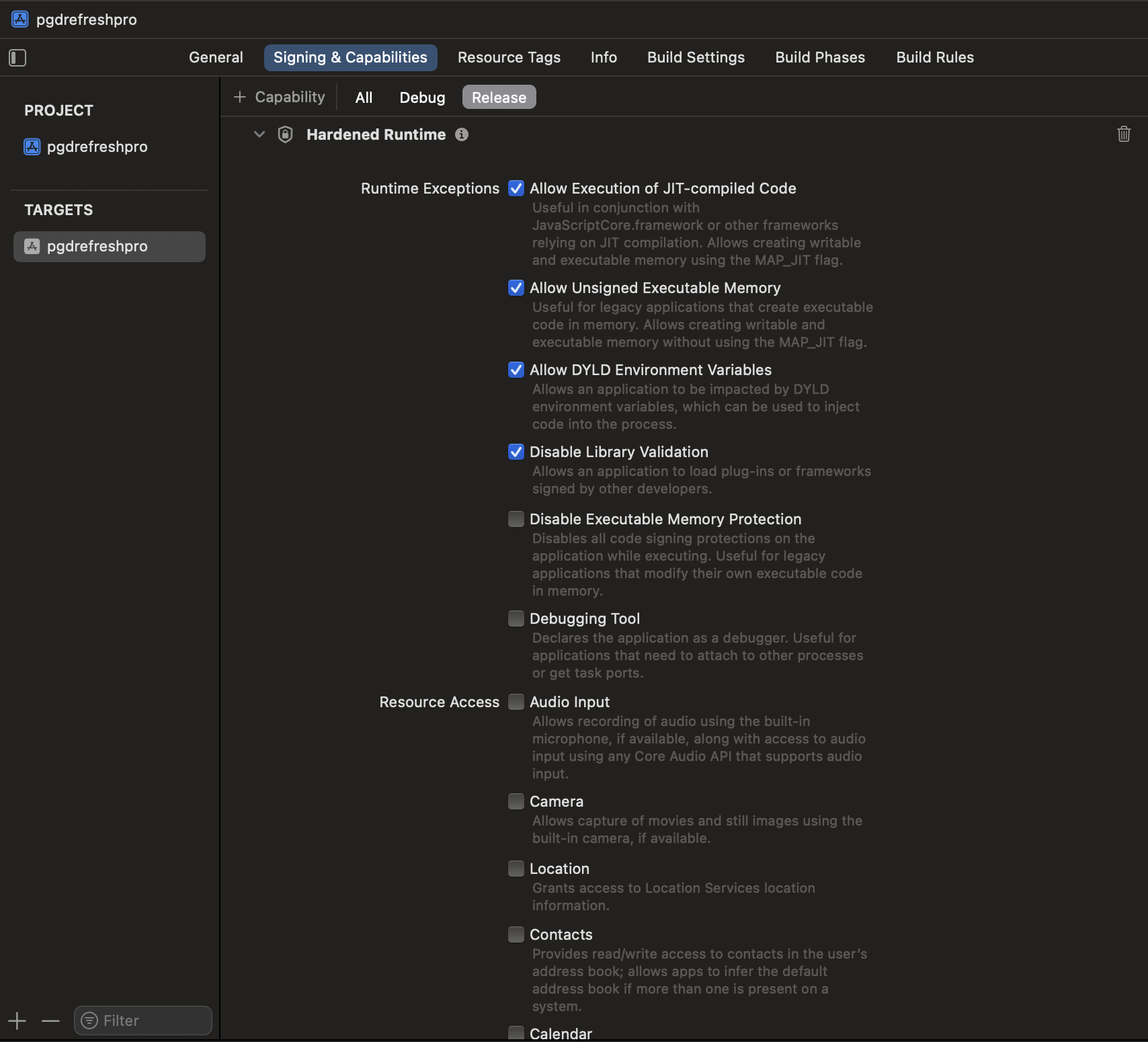

  • Since we were not using XCode for building our application, we created a dummy project.
  • We selected "App" under "Applications"
  • Then we provided the following details:
	"Product Name": pdgrefreshpro
	"Organization Identifier": "com.prograde"
	"Bundle Identifier": "com.prograde.pgdrefreshpro"
  • The project got created and we edited the pdgrefreshpro.entitlements as follows:
	<plist version="1.0">
	<dict>
		<key>com.apple.security.cs.allow-jit</key>
			<true/>
			<key>com.apple.security.cs.allow-unsigned-executable-memory</key>
			<true/>
			<key>com.apple.security.cs.allow-dyld-environment-variables</key>
			<true/>
			<key>com.apple.security.cs.disable-library-validation</key>
			<true/>
			<key>com.apple.security.device.usb</key>
			<true/>
			<key>com.apple.security.app-sandbox</key>
			<true/>
	</dict>
	</plist>
  • Then we went to "Signing & Capabilities" and selected "Automatically manage signing". But we are seeing "None Required" under "Provisioning Profile" section.
Sorry about that, this was my mistake. Quinn reminded me that the "com.apple.security.*" macOS entitlements are unrestricted, which means they're just added directly to the executable entitlements and are not included in the provisioning profile
So, going back to the beginning of things, I have a new guess as to what's going on here. The "core" error here is the kernel denying access:

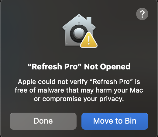

Hi Kevin
Sorry for taking some time to respond, we were facing some notarization issues. That got resolved today. We tried adding the NSRemovableVolumesUsageDescription property key in our electron app. With this, it is working! We are getting a pop-up requesting file access after which, the deny error is no longer coming.
Thanks for pointing us to the right direction! Going forward, we'll be using this property key during our notarization. Thanks a lot for the help.

Hi Kevin
We tried creating a notarized build after this fix. However, we are facing a prompt on macOS while opening our Application. Attaching screenshot.
To debug this, we reverted our code to a release which was not giving us this prompt(removed the fix as well for now). We then created a notarized dmg again. With this, the prompt started showing up here as well.
When we directly run the dmg in the dev machine, it does not give us the prompt. But if we download it from somewhere and run, the prompt comes up even in dev machine.
We executed some commands to verify the notarization:
  1. spctl --assess -vv /Applications/Refresh\ Pro.app
On the dev machine, the output was "accepted" but on other machine, it was "rejected". Output as follows:
/Applications/Refresh Pro.app: rejected
source=Notarized Developer ID
origin=Developer ID Application: Prograde Digital Incorporated (*******)
  1. xcrun stapler validate /Applications/Refresh\ Pro.app
On dev machine, we executed this command and the output is as follows.
Processing: /Applications/Refresh Pro.app
The validate action worked!
  1. codesign -vvv --deep --strict /Applications/Refresh\ Pro.app/
/Applications/Refresh Pro.app: valid on disk
/Applications/Refresh Pro.app: satisfies its Designated Requirement
I believe this issue is not linked to the new property added as we tried this on reverted code as well.
We have created a bug attaching the dmg. Please suggest anything we can try to make the release out the door.
Bug link- https://feedbackassistant.apple.com/feedback/16811025
Thanks again for helping us through this.
