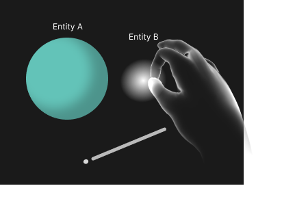

Context: I’m trying to create an invisible bound around Entity A, so when my hand approaches the bound to grab Entity A, a nice spotlight hover effect would fire first on the bound before hand reaching entity A.

Thanks for the response! If I were to implement a design as below: where my hand can grab entityA that sits inside entityB that is transparent, when the hand is close to the entity B bound, a spotlight effect will fire. Seems like having both entity A and Entity B as input target wont work? Should I shoot a raycast from the index finger and link the hit position on the entity B collider to a custom shader material? I'm still quite new to Swift, wondering if there is a simple solution?
