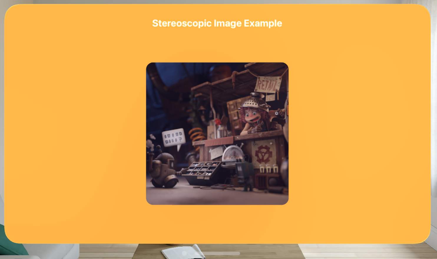

With the plane approach and setting the background to orange for visibility I see the attached screen shot.
