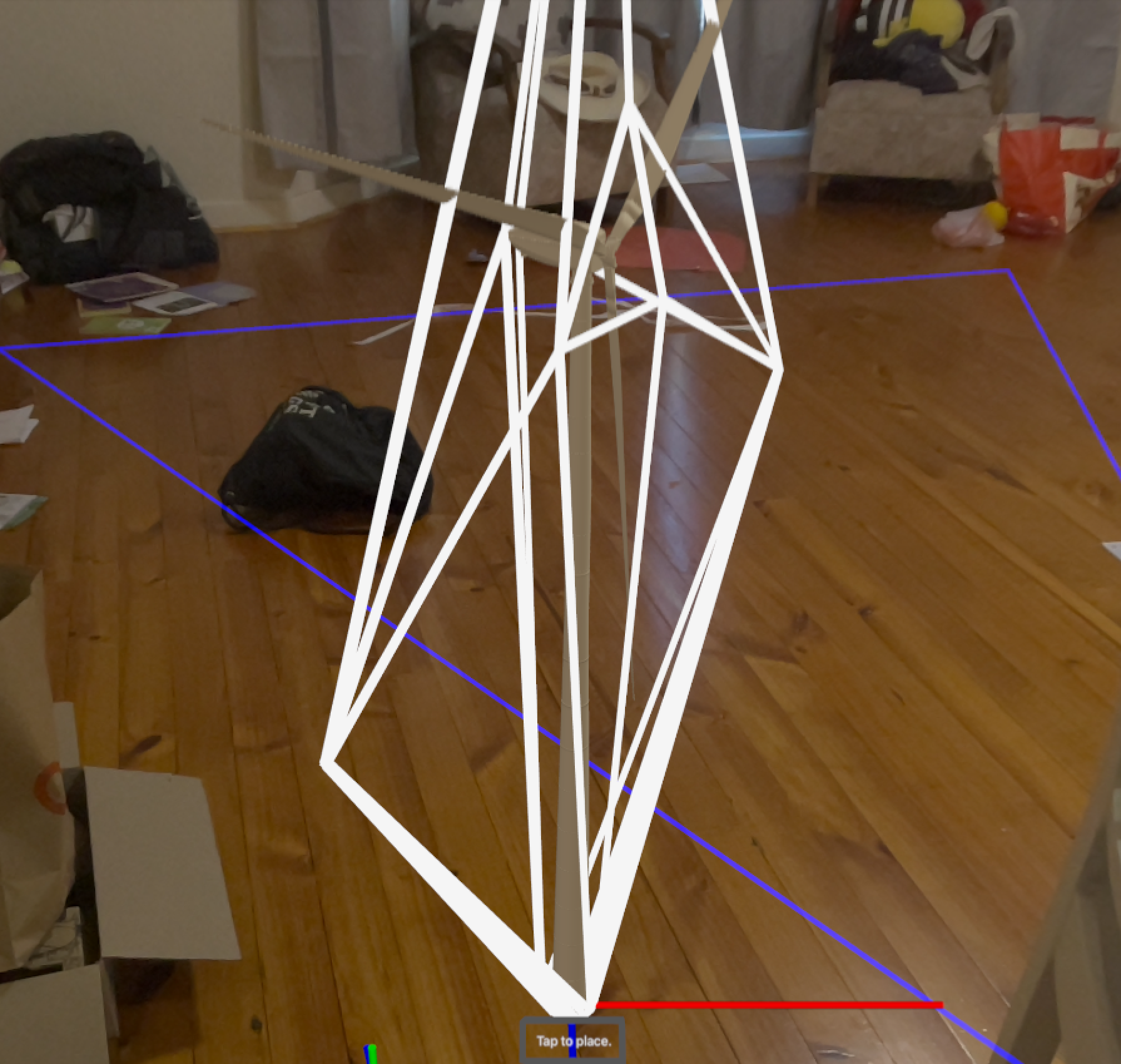

Good call out. I did not use an animating 3D model, but I should have. Is the animation baked into a USD file? I just tested an animating USD and its entity's collision shape did not follow the animation. Can you visualize your collision shapes and tell me if they look as expected? Here's how to use Xcode to do that:
  • In debug mode open "Debug Visualizations" by clicking the button to the right of the "step out" button in the "Debug Area" (bottom pane). It kind of looks like a box.
  • Select "Collision Shapes and Axes".
  • Doing this will outline the collision shapes around the entities in your application.
  • Verify your collision shapes are correct.
Please let me know how it goes.

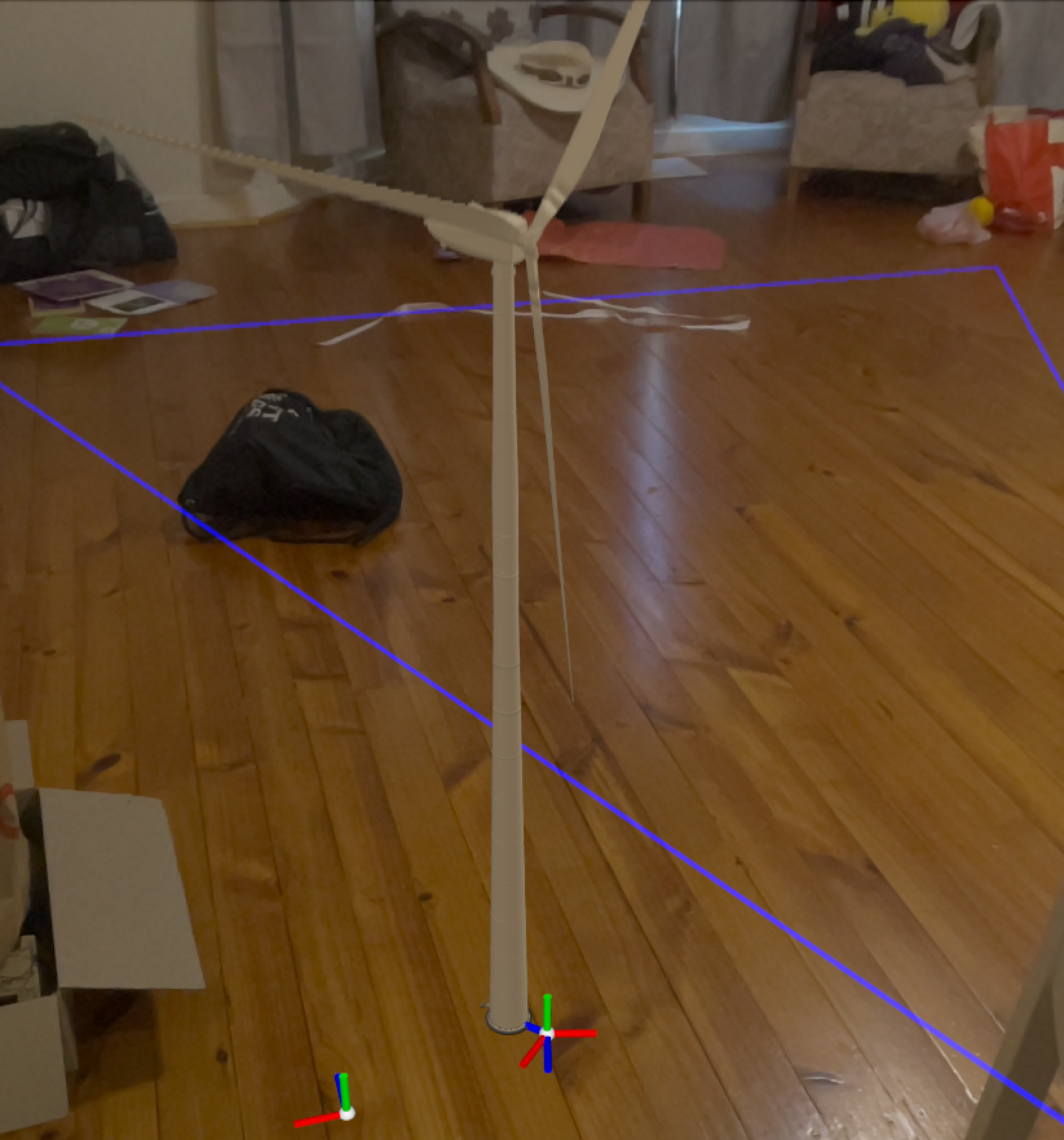

Hi
Yes, the animation is baked into the USD file. I followed your advice and it does have an issue with collision. The model in preview i.e. before placement shows collision with white lines but the one after does not have the white lines. I do have the section where collision component is created but is there something I'm doing wrong? Thanks
