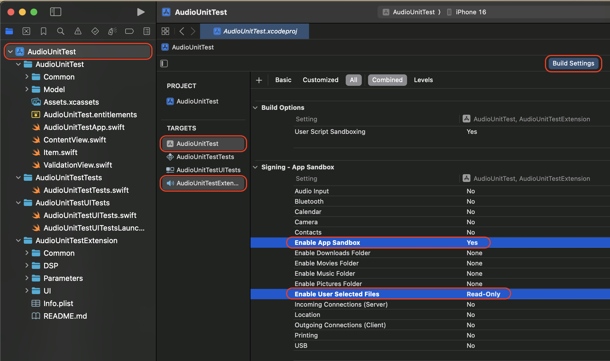

I managed to make it work but not sure why. Entitlements wise I use App Sandbox is YES but under Build Settings Enable App Sandbox is Default set to YES for a new project and if I change to No, my app + extension get installed correctly.
This setting seems to be not relevant for iOS and only for macOS is it?

This issue still exists in Xcode Version 16.3 (16E140).
To fix the Audio Unit Extension App template to allow installation to an iOS device, you must reset these two Build Settings in the section Signing - App Sandbox :
  • Enable App Sandbox
  • Enable User Selected Files
To reset, highlight the row and click delete.
These build settings need to be reset for both targets:
  • App target
  • Audio Unit Extension target

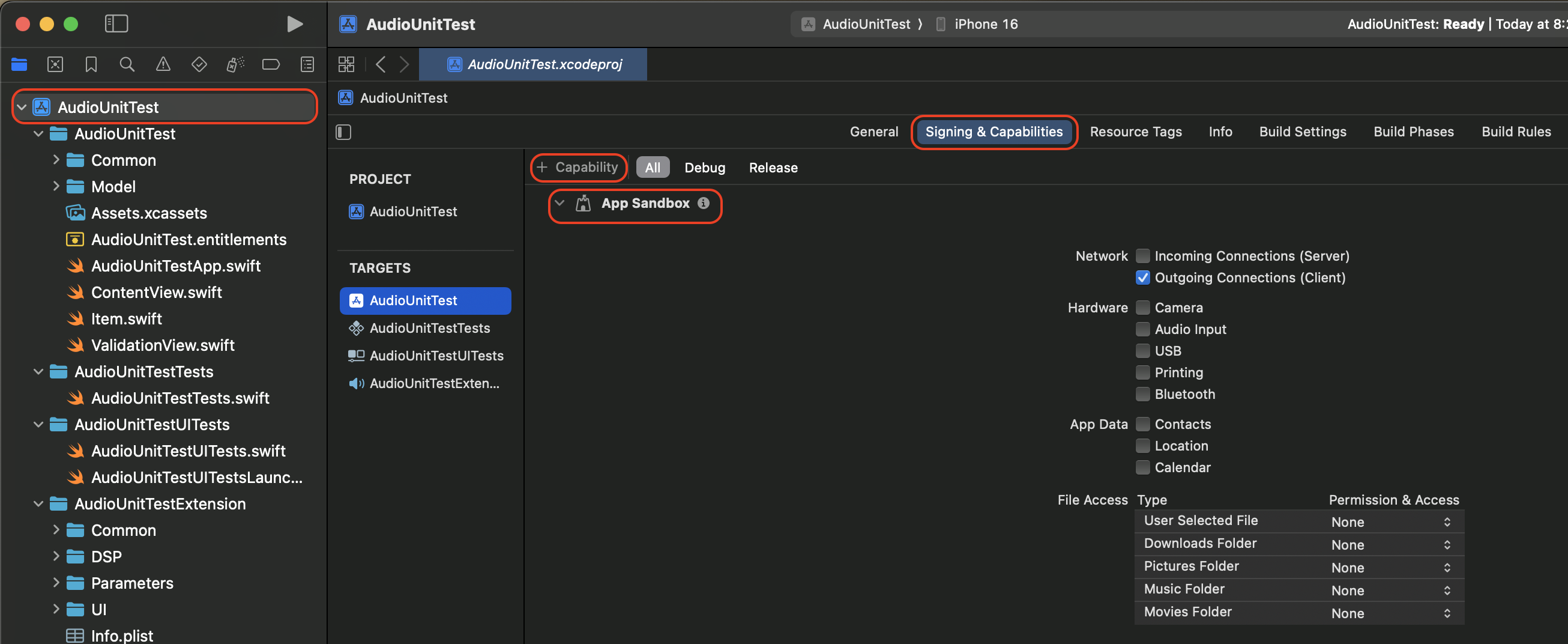

As Quinn mentions, if you want to deploy to the macOS App Store, you still need to enable App Sandbox. Go to the Signing and Capabilities tab > click + Capability > choose App Sandbox.
