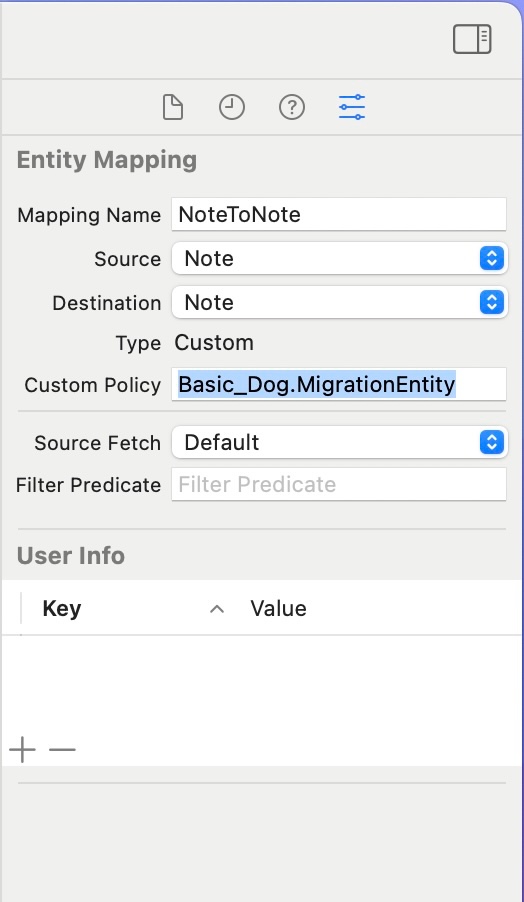

I am trying to add a custom policy to Entity Mapping and it refuses to work because the app name has a space in it. I tried replacing the space character with underscore and hyphen but it still does not work.
I tried creating an MVP where app name did not have any space and it worked in the first try. However, for another MVP where app name had a space in it, it is not working at all.

The custom policy name you put in the Core Data model is the name of your custom policy class (NSEntityMigrationPolicy), and a space isn't allowed in a class name. I don't expect that a underscore doesn't work, but a custom policy name isn't tied to the app name, and so you can just choose a name that works for you.
The space is in the App name not in the class name.
I thought it was the custom policy name, as shown in your screenshot. Sorry for that.
It will be really strange to me if you meant a space in your app name leading to an issue in your custom policy. If you can provide a minimal project that contains only the code relevant to the issue, I'd be interested in taking a look.
