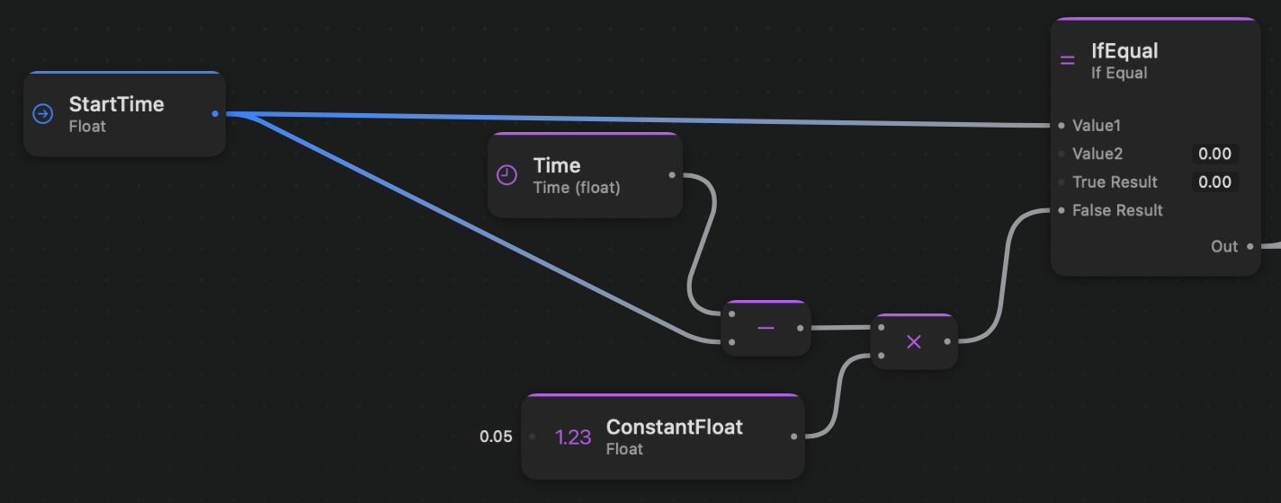

I'm trying to build a Shader in "Reality Composer Pro" that updates from a start time. Initially I tried the following:
The idea was that when the startTime was 0, the output would be 0, but then I would set startTime from within code and this would be compared with the current GPU time, and difference used to drive another part of the shader graph:

However, I haven't found a reference to the time the shader would be using.
So now I am trying to write an EntityAction to achieve the same effect. Instead of comparing a start time to the GPU's time I'm trying to animate one of the shader's uniform input. However, I'm not sure how to specify the bind target. Here's my attempt so far:

Answered by Vision Pro Engineer in 823933022
Hi @peggers123
ShaderGraphMaterial doesn't support parameter animation with EntityAction at the moment. If you'd like us to consider adding the necessary functionality, please file an enhancement request using Feedback Assistant.
That being said, you can still achieve your desired effect by utilizing RealityKit's Entity Component System (ECS) to animate your material's parameters.
