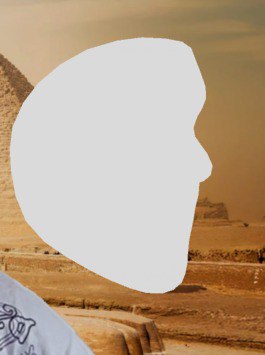

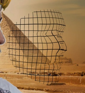

I'm developing an AR effect using SceneKit and applying a transparent material to a face mesh. However, I'm facing an issue where the front faces of the mesh overlap each other, causing incorrect rendering.
Problem:
The front faces of the mesh overlap with each other when transparency is applied. This causes areas like the cheeks to be visible through the nose, even though they should be occluded. Expected Behavior: The material should behave as if it were opaque to itself—that is, overlapping front faces should be occluded properly, while still allowing transparency for background elements. Actual Behavior: The mesh renders its own front faces incorrectly, making parts of the face visible through others when they should be blocked.
What I Have Tried:
testMaterial.writesToDepthBuffer = true
testMaterial.readsFromDepthBuffer = true
Question:
👉 How can I prevent SceneKit's transparent material from rendering overlapping front faces?
👉 Is there a way to force SceneKit to treat its own mesh as opaque for itself while still being transparent to the background?
👉 Does SceneKit support a proper depth pre-pass or an equivalent to Unity’s ZWrite shaders to solve this issue?
Attached screenshots demonstrate the problem visually. Any help would be greatly appreciated! 🚀
