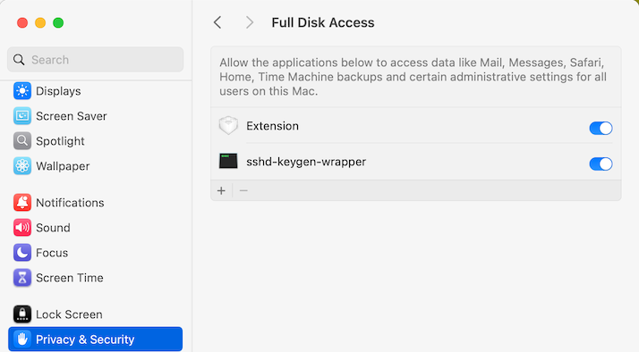

I am following pretty much the same steps, but with no luck. Question regarding step 13 : you said that you enabled the extension. Do you mean that you enabled only the extension and not the App Bundle containing the extension?
Ah, yes, sorry about the confusion there. I went to System Settings > Privacy & Security > Full Disk Access and enabled whatever was there. I don’t actually recall whether it was showing the app or the extension. And I’ve deleted that VM… oh wait… I didn’t get around to deleting the VM, so I can go check…
It turns out that the UI was showing the extension, and that’s what I enabled. Consider:
