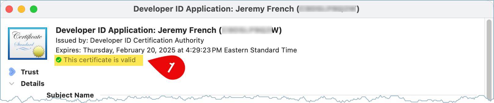

When I look at my Certificate Expiring 02-20-2025, I see a valid status displayed. (See annotation #1.)
However, when I look at my Apple Developer ID Certificate renewal, I see the words not trusted. (See annotation #2.)

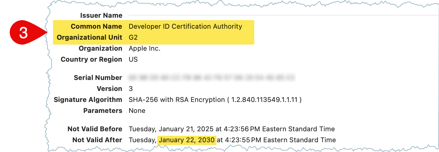

My invalid certificate shows two names (see annotation #3).

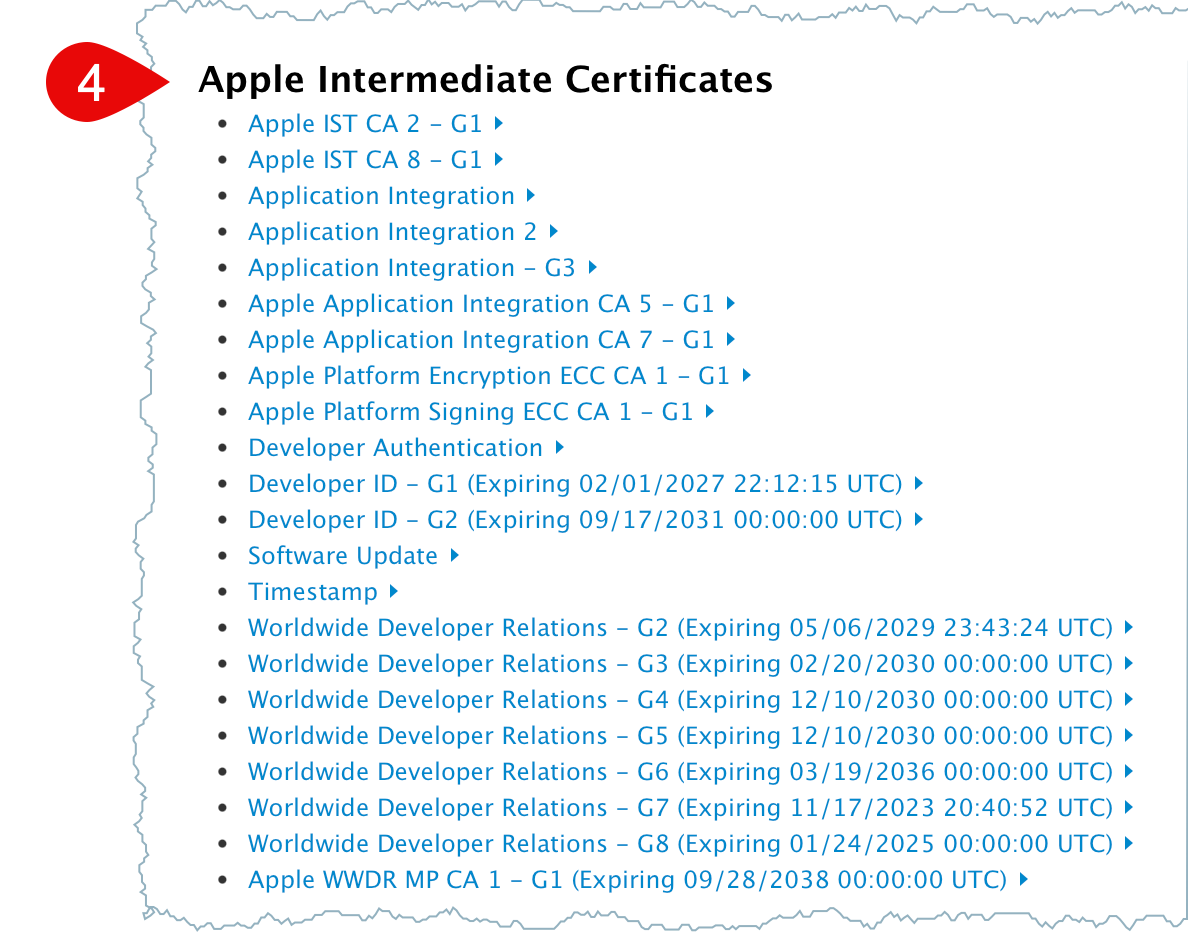

On the Apple PKI page, I see these Apple Intermediate Certificates (see annotation #4).
However, the Common Name and Organizational Unit names do not precisely match the Apple Intermediate Certificates page names.

Usually I just download them all (-: The system is good at finding intermediates that it needs and ignoring any extras.

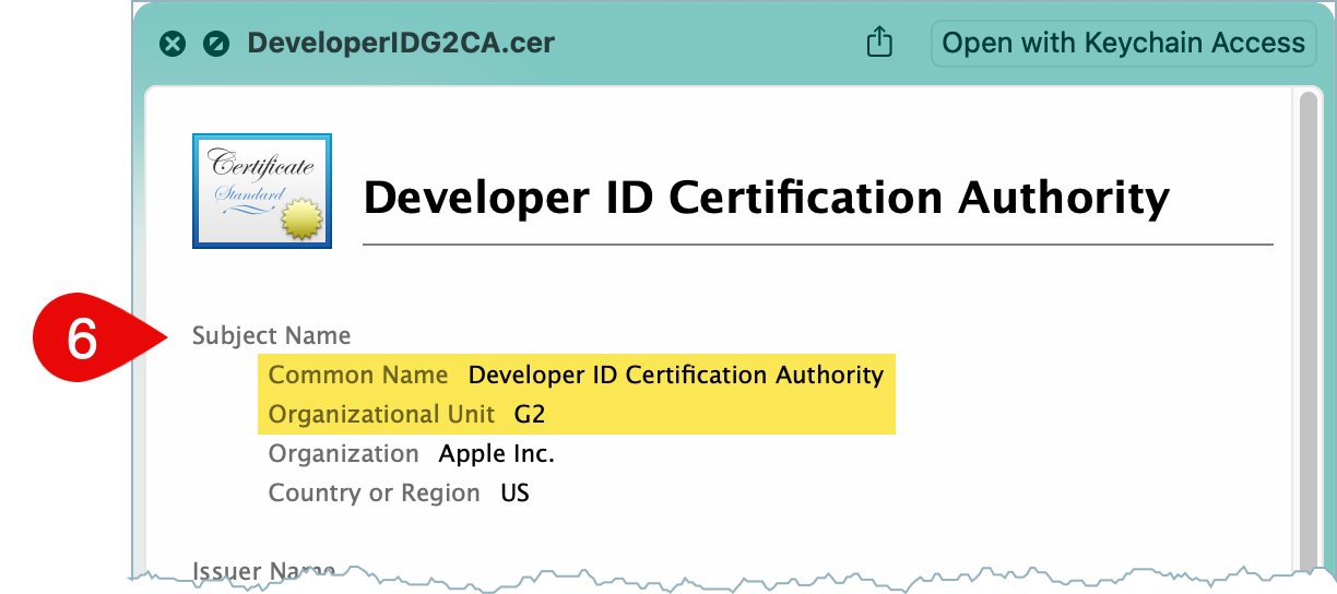

However, as you’re asking, the one you’re looking for is Developer ID - G2 (Expiring 09/17/2031 00:00:00 UTC). If you download that and Quick Look it in the Finder, you’ll see its Subject Name details match the Issuer Name details from your screen shot.

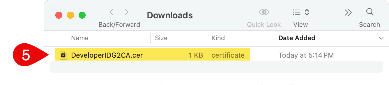

I downloaded and saw a file named DeveloperIDG2CA.cer (see annotation #5).
In the Finder, I selected DeveloperIDG2CA.cer in the Downloads folder and chose File -> QuickLook (see annotation #6).
The names in DeveloperIDG2CA.cer match the names in my untrusted Developer ID Application. (That's the one with the period from 01-21-2025 to 01-22-2030.)
