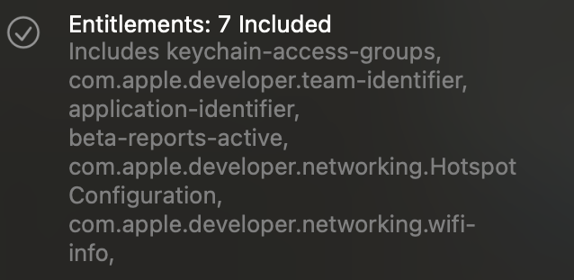

However, when I look at the provisioning profile being used, it seems to have the correct entitlement:
I've also tried enabling automatic signing (instead of the current manual signing using match), as well as generating an adhoc profile and re-adding the device UDID in developers.apple.com. None of these have worked.
This issue appeared within the past day or so and was working fine yesterday with no code changes, so I've been stumped. All my certs are relatively new and were issued within the past few months. I've tried regenerating the provisioning profiles using match, but this gives the same thing.
What's odd is that I can run the build and upload to testflight, then download and install the app just fine through there. But this obviously makes debugging an issue.
