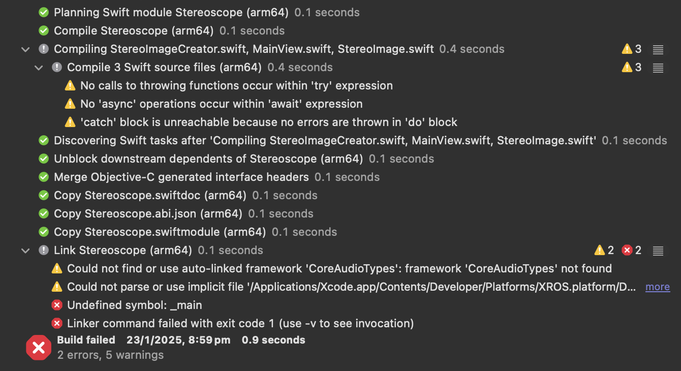

The problems shown in the log are: Undefined symbol: _main Linker command failed with exit code 1 (use -v to see invocation)
The first error seems to say that there's no "main" but there is indeed a @main in the EntryPoint.swift file.
Any ideas? I have archived other apps (built from scratch) successfully, but clearly there's something different about this sample code.

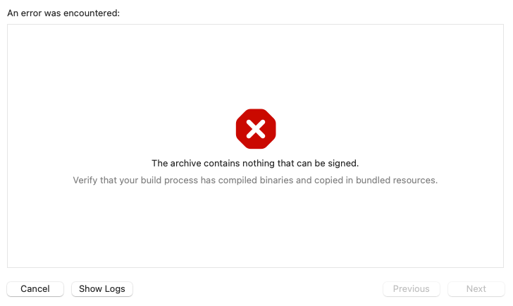

However, I can't distribute the app, because "The archive contains nothing that can be signed." Something's clearly a bit funky here, but the app works just fine on-device.

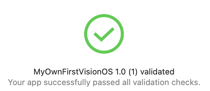

Starting from the VisionOS template, in Xcode 16.2, I was able to Archive (for validation).
I just had to add the icons and give a name that was not yet used.
Thanks very much for trying it out — I've just tried again and it's still failing for me. I've given a unique name and added icons but I'm getting the same error. I am able to archive another app I've been working on, so it's specific to this project.
I get the error when choosing Product > Archive. Running the app works fine, installing to the Vision Pro works fine. I've attached a snap from the failed build log.

This is very strange. I don’t know the cause, but it’s definitely bugworthy.
Consider this:
  1. On macOS 15.2, download the CreatingStereoscopicImageInVisionOS sample.
  2. Unpack it and open the project with Xcode 16.2.
  3. In Signing & Capabilities, select your the team in the Team popup.
  4. Choose Product > Archive; it fails with the error you’re reporting.
  5. In the Project navigator, drag MainView.swift, StereoImage.swift, and StereoImageCreator.swift to the App group, right next to EntryPoint.swift.
  6. Choose Product > Archive. This time it works.
I can’t even begin to speculate as to what’s causing this error, or why step 5 suppresses that error. I’d appreciate you filing a bug about it so that the Xcode team can dig into it.
