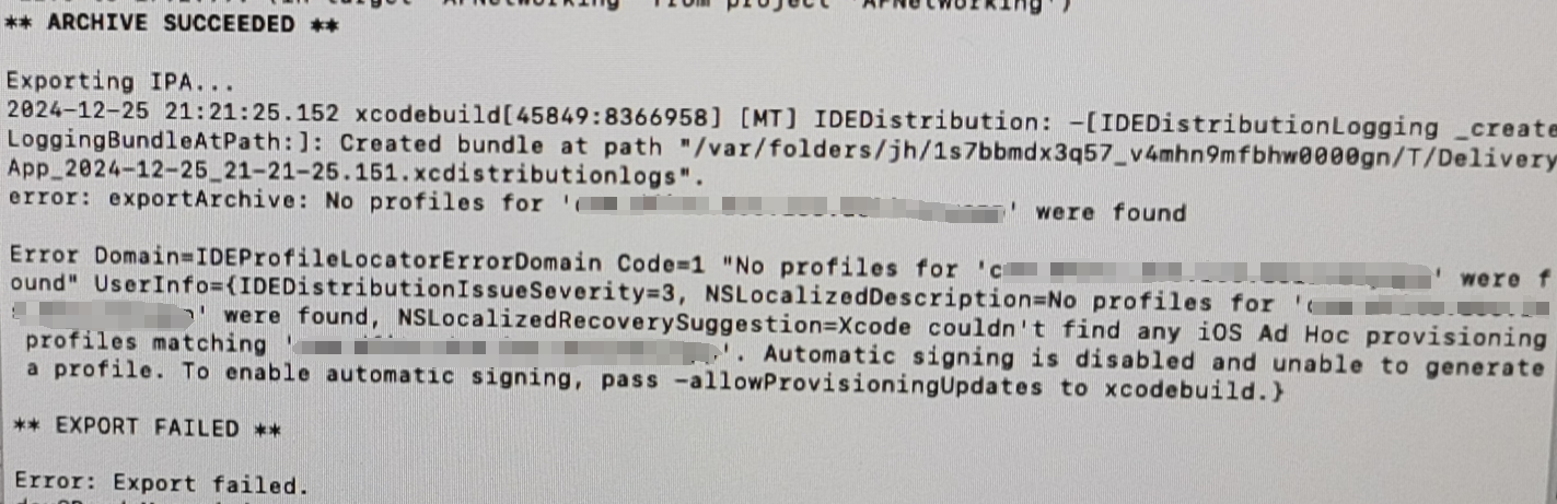

Not just that, but also generate the provisioning profile.

error message
