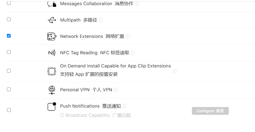

Why is there no "Packet Tunnel" option under "Network Extensions" in Identifiers & Capabilities? Thank you, my dear Eskimo, for your help. Could you please assist me with this issue? @ Developer Technical Support @ Apple
The capabilities you add to your App ID flow through to the entitlement allowlist in your provisioning profile. If you dump the profile you’ll see that the NE entry in its allowlist authorises that App ID to use any of the standard NE provider values. In Xcode, in Signing & Capabilities, you get to choose which NE provider values your actually claim.
I think you’ve misunderstood how provisioning profiles work. I recommend you have a read of TN3125 Inside Code Signing: Provisioning Profiles.
我现在想了解的是:packet tunnel权限需要向苹果公司单独申请吗?还是说所有苹果的开发者账号都可以使用,而无需申请? 十分感谢您的解答@ The Eskimo! @ Developer Technical Support @ Apple
Here’s my current question: Does the packet tunnel entitlement require a separate application to Apple, or is it available to all Apple developer accounts without the need for an additional application?
Thank you very much for your help, @The Eskimo! @Developer Technical Support @Apple
Any paid team can implement a packet tunnel provider. See Developer Account Help > Reference > Supported capabilities (iOS).
