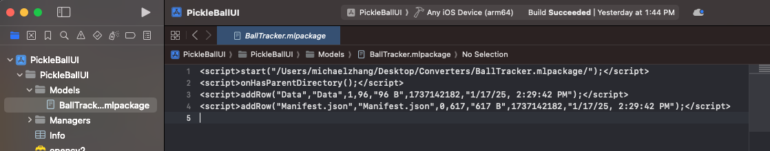

However, when I drag it into Xcode, it just shows up as 4 script tags instead of the model "interface" that is typically expected.
I'm not sure I understand what 4 script tags mean. Maybe could you attach a screenshot?

Yes, this is what I am seeing in Xcode.
xcrun coremlcompiler metadata path/to/model.mlpackage says the following:

Oh interesting. BallTracker_42137490.mlpackage is literally a text file with the contents:
(base) ➜  Downloads hexdump -C BallTracker_42137490.mlpackage
00000000  3c 73 63 72 69 70 74 3e  73 74 61 72 74 28 22 2f  |<script>start("/|
00000010  55 73 65 72 73 2f 6d 69  63 68 61 65 6c 7a 68 61  |Users/michaelzha|
00000020  6e 67 2f 44 65 73 6b 74  6f 70 2f 43 6f 6e 76 65  |ng/Desktop/Conve|
00000030  72 74 65 72 73 2f 42 61  6c 6c 54 72 61 63 6b 65  |rters/BallTracke|
00000040  72 2e 6d 6c 70 61 63 6b  61 67 65 2f 22 29 3b 3c  |r.mlpackage/");<|
00000050  2f 73 63 72 69 70 74 3e  0a 3c 73 63 72 69 70 74  |/script>.<script|
00000060  3e 6f 6e 48 61 73 50 61  72 65 6e 74 44 69 72 65  |>onHasParentDire|
00000070  63 74 6f 72 79 28 29 3b  3c 2f 73 63 72 69 70 74  |ctory();</script|
00000080  3e 0a 3c 73 63 72 69 70  74 3e 61 64 64 52 6f 77  |>.<script>addRow|
00000090  28 22 44 61 74 61 22 2c  22 44 61 74 61 22 2c 31  |("Data","Data",1|
000000a0  2c 39 36 2c 22 39 36 20  42 22 2c 31 37 33 37 34  |,96,"96 B",17374|
000000b0  37 32 36 36 39 2c 22 31  2f 32 31 2f 32 35 2c 20  |72669,"1/21/25, |
000000c0  31 30 3a 31 37 3a 34 39  e2 80 af 41 4d 22 29 3b  |10:17:49...AM");|
000000d0  3c 2f 73 63 72 69 70 74  3e 0a 3c 73 63 72 69 70  |</script>.<scrip|
000000e0  74 3e 61 64 64 52 6f 77  28 22 4d 61 6e 69 66 65  |t>addRow("Manife|
000000f0  73 74 2e 6a 73 6f 6e 22  2c 22 4d 61 6e 69 66 65  |st.json","Manife|
00000100  73 74 2e 6a 73 6f 6e 22  2c 30 2c 36 31 37 2c 22  |st.json",0,617,"|
00000110  36 31 37 20 42 22 2c 31  37 33 37 34 37 32 36 37  |617 B",173747267|
00000120  30 2c 22 31 2f 32 31 2f  32 35 2c 20 31 30 3a 31  |0,"1/21/25, 10:1|
00000130  37 3a 35 30 e2 80 af 41  4d 22 29 3b 3c 2f 73 63  |7:50...AM");</sc|
00000140  72 69 70 74 3e 0a                                 |ript>.|
00000146
The correct .mlpackage is supposed to be a bundle (= directory.) So, this file is just broken.

I would suggest to remove the current BallTracker_42137490.mlpackage from the Xcode project and then add the one that works correctly with coremlcompiler metadata command.
Oh, that is interesting. The BallTracker.mlpackage file I attached to the feedback assistant was the one I ran the xcrun coremlcompiler metadata path/to/model.mlpackage command on. If this produces:

So, somewhere between coremltools and Xcode, BallTracker.mlpackage got replaced with some text garbage. The attached file in the feedback assistant was also broken, as I showed above.
It can be some file operation user error, a bug in APFS file system (unlikely), or misbehaving disk drive (very unlikely). Sorry, I have honestly no idea. It seems to me something outside of CoreML framework.
You can verify whether your Xcode project has a broken one or a good one by:
xcrun coremlcompiler metadata $(find /path/to/your/Xcode/project/ -name "BallTracker.mlpackage")
I found out what it was. I can't drag the model directly from VSCode to Xcode so I first drag the file onto my desktop. This makes it show up as a txt for whatever reason so I had to import the file by adding the file from Xcode, and referencing the file in VSCode directly.
