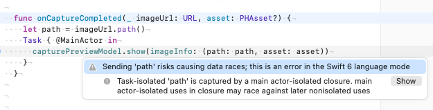

I'm trying to fix some Swift6 warnings, this one seems too strict, I'm not sure how to fix it. The variable path is a String, which should be immutable, it's a local variable and never used again inside of the function, but still Swift6 complains about it being a race condition, passing it to the task
What should I do here to fix the warning?

Thanks for taking a look. I tried some more things and it looks like it's a misleading compiler error, maybe nothing to do with the path variable at all even though the compiler says it is.
I took the path variable out of the function temporarily, then it gave another error: "Task or actor isolated value cannot be sent; this is an error in the Swift 6 language mode".
The containing class is marked as @Observable, so I'm assuming really it is complaining that "self" is getting pulled into the Task which can cause race conditions even though the compiler error does not say that. I added the Sendable protocol to the container class and the warning went away.
Right. That’s why I was trying to reproduce it. I originally suspected that this was caused by you putting both values into a tuple, but I wasn’t able to confirm that because I could never reproduce the problem. If you can help me out there, that’d be grand.
Oh, and it’ll also make for a reduced test project that you can use to file a bug about the misleading diagnostics.
