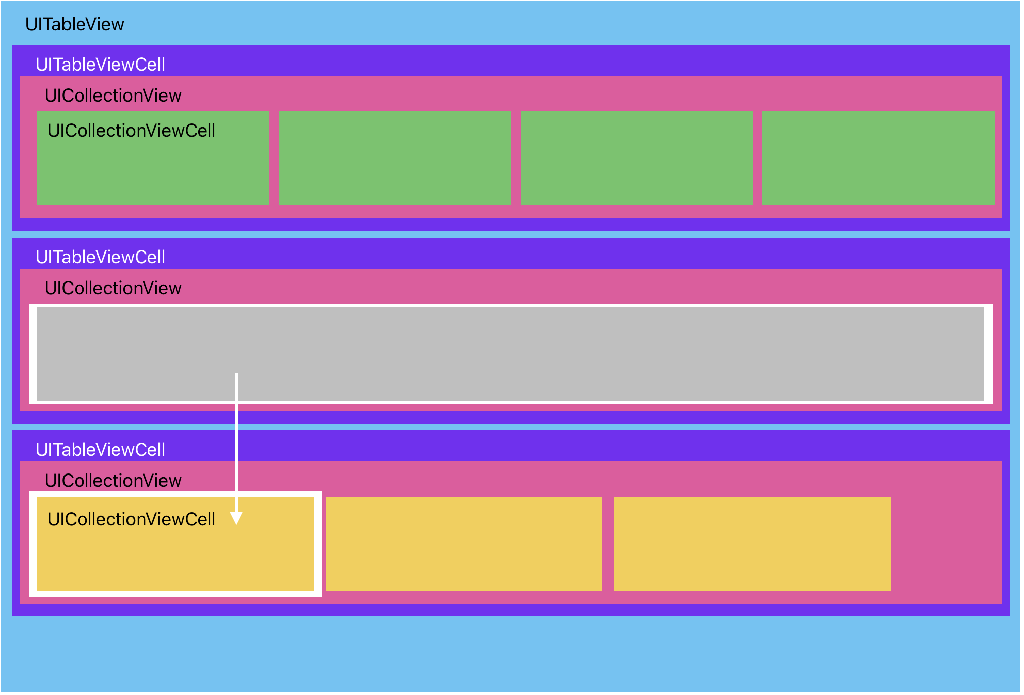

I'm running into a problem with the focus order in my UICollectionView in my tvOS app. The layout of my app is outlined in the following diagram
On the uppermost layer I have a UITableView, each cell containing a single UICollectionView that can contain a variable number of UICollectionViewCells.
When the user swipes down, I want the left-most item in the next row down to be selected, as follows:

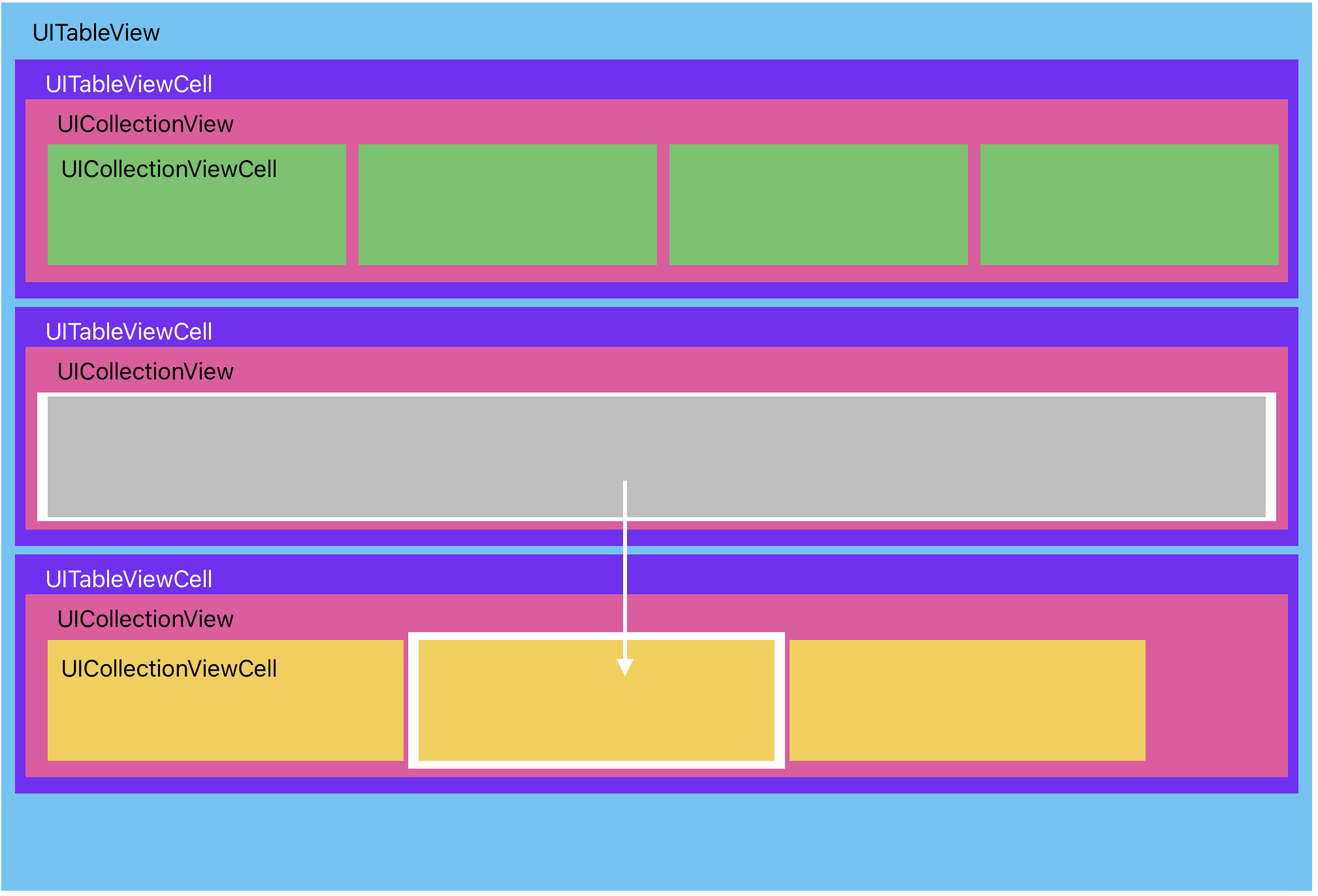

I've been able to get this to work for the majority of cases. The exception is when the previously focused item extends to the length of the screen - in this case the next focused item isn't the leftmost item, but rather the center item, as follows.
Using focus guides won't really fit the use case here since collection views are dynamically generated.
I've found that there is a function in UICollectionViewDelegate, indexPathForPreferredFocusedView that should help here but it only seems to be called intermittedly, even though I have set remembersLastFocusedIndexPath on the collectionview to true. I can force it to be called by calling setNeedsFocusUpdate() but I can't figure out a good place to call it - shouldUpdateFocus is too early and didUpdateFocus is too late.
Is there some way to constrain the focus area of a view to a certain subset of it's frame - for example, the left-most quarter of its width?
Or does anyone know of some other solution to this problem?
Answered by Engineer in 821293022
We don't recommend nesting re-usable containers (UITableView with UICollectionView(s) and its cell(s) as subviews).
Instead you should use a UICollectionView with a compositional layout to achieve this layout. Once you refactor, it will be much easier to control focus. You can't constrain focus to a smaller portion of a view unless that small portion is a subview itself. You can create a layout like this, but you will need to use a subview that can become focusable to achieve it.
