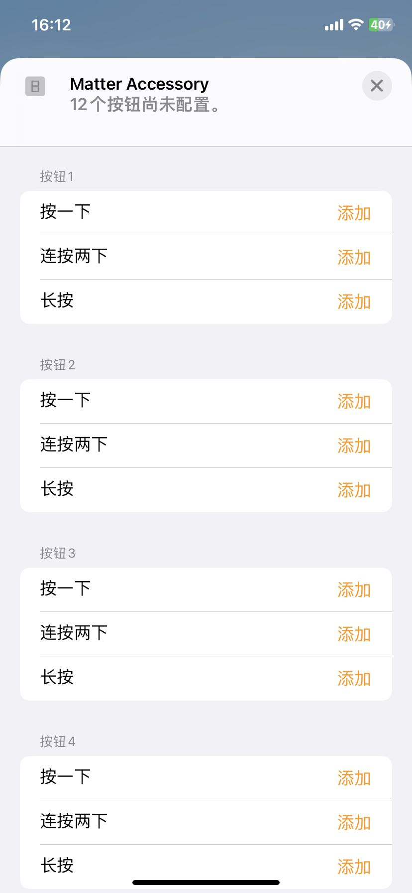

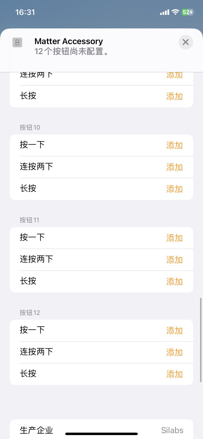

There is a mapping issue between the physical buttons of the Matter switch and the buttons on the Apple Home App.
My device is a Matter switch with 12 buttons, but its physical buttons do not correspond to the button icons displayed in the Apple Home App. The mapping between them is chaotic, for example, physical button 1 is mapped to button icon 3, and physical button 2 is mapped to button icon 7, without any pattern. And every time the factory settings are restored and the network is reconfigured, the mapping will be different from the last time, and restoring the factory settings will change it again. I have checked my program and I am certain that the events triggered by physical buttons correspond correctly to the Matter Generic Switch Endpoint in the ZCL file. I don't understand why there was such a mistake. I am using GSDK 4.4.1, Silicon Labs Matter 2.2.1-1.2. I asked the manufacturer of the chip (the staff of Silicon Labs), and they said that the corresponding order displayed on the app is determined by the APP side, and has nothing to do with Matter devices, is this a problem caused by Apple's system, and if so, is there any solution?
