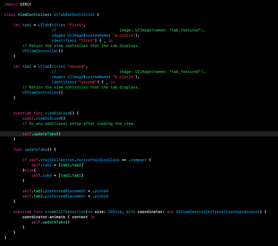

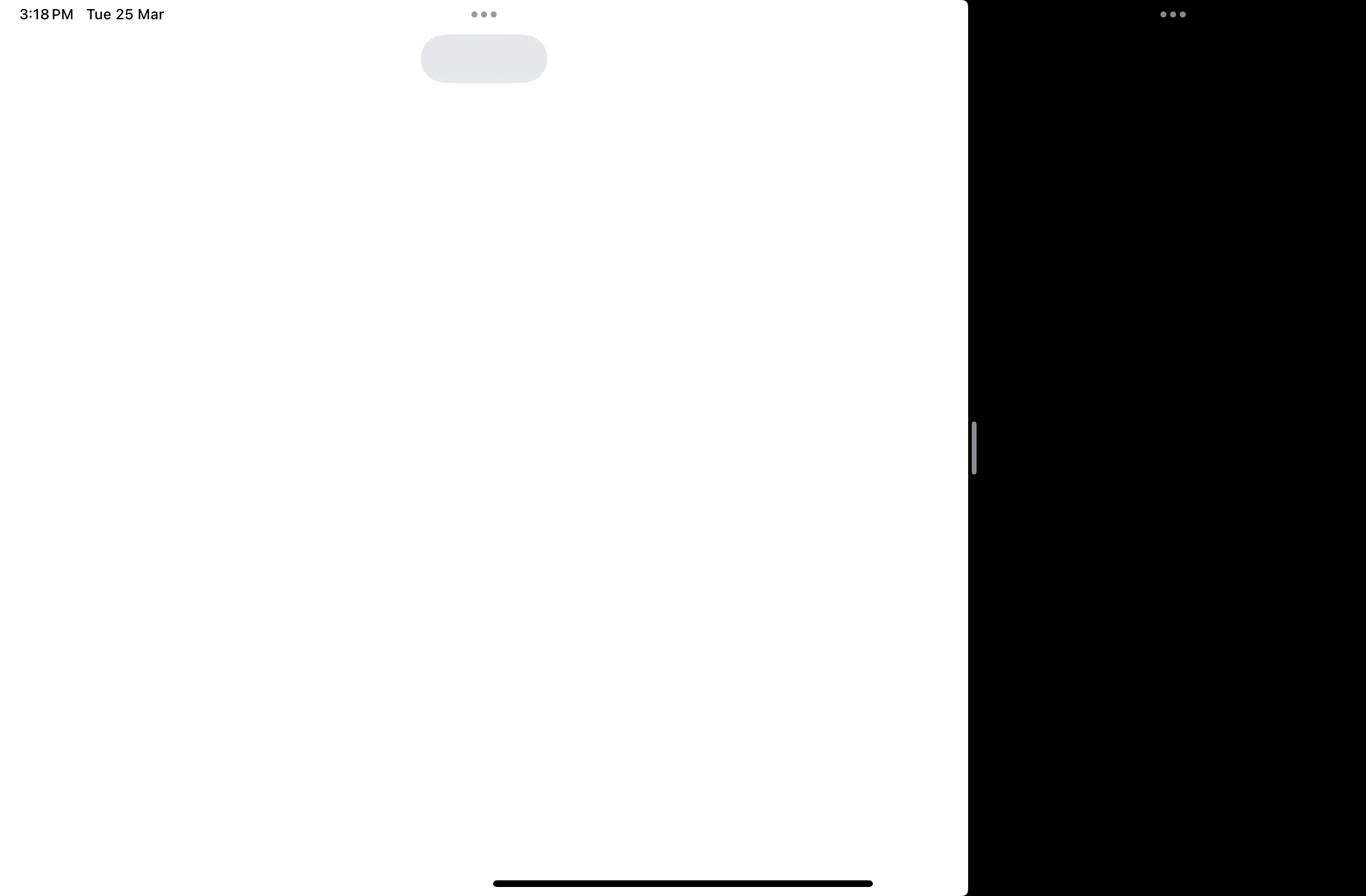

Split View from Compact to Regular with pinned tabs will cause rendering issue
More specifically, if I have 2 pinned tabs that are displayed in different order for compact and regular and switch between compact and regular, when it gets to regular mode, the images for both tabs will not be rendered. The tabs can still be pressed, just the icon is missing.

Hi, here is a screenshot of the code I am testing with. I am running an iPad mini and use split view. Then I change size by rotating or change split view. Eventually the the pinned tabs will not render the icon.
