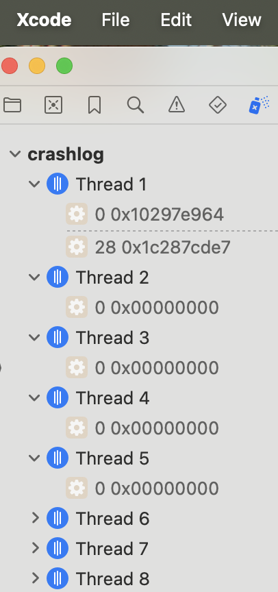

I have uploaded my app to App Store Connect TestFlight. Then I have downloaded it in TestFlight on my iPad. But the app always crashes a few seconds after opening. It seems to be always the same issue. I have a few crash reports in App Store Connect-->App name-->TestFlight-->Feedback-->Crashs. I have opened a crash report in Xcode but I don´t find the error that causes the crash. How can I find the error in Xcode? Is it possible to find the class and line in the class where the crash happened? In addition, how can I export a crash report from Xcode?
The crash doesn´t happen in debug mode on my iPad, it only happens when I install and open my app after downloading it from TestFlight on my iPad.

I have opened the file crashlog.crash in Xcode-->Window-->Devices and Simulators. What should I do now to symbolicate the frames in the crash report?

It worked to symbolicate the lines in Terminal. But I don't get more informations here than in Xcode about the crash. When I go to App Store Connect-->My app-->TestFlight and then open my crash report in Xcode then I get the same messages than in the macOS Terminal.
Frames 3 through 0 are your code.
Messages from macOS Terminal for Frames 3 through 0:
SharedCodeProject_MyClass__Updated__301_MoveNext (in MyGameiOS) (<unknown>:1)
System_Runtime_CompilerServices_AsyncMethodBuilderCore_Start_TStateMachine_GSHAREDVT_TStateMachine_GSHAREDVT_ (in MyGameiOS) + 388
MyGameiOS_SharedCodeProject_MyClass_Update_Microsoft_Xna_Framework_GameTime (in MyGameiOS) + 184
-[iOSGameView doTick] (in MyGameiOS) (registrar.mm:13304)
What does (<unknown>:1) mean? In which line in my class did the error happened? Is it normal that there is no error or exception message displayed here?
