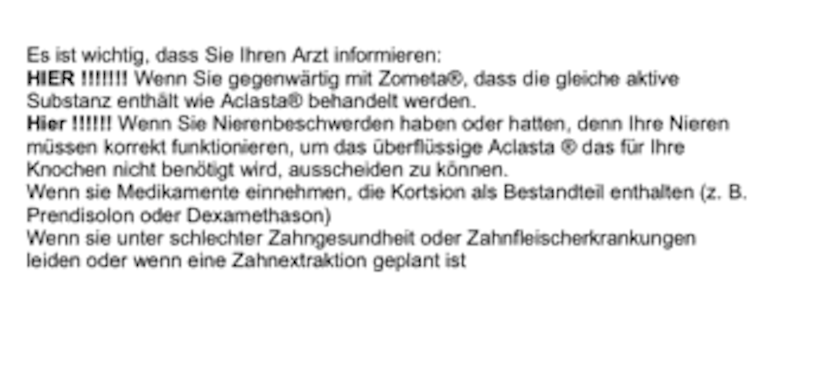

DESCRIPTION OF PROBLEM Since Xcode Version 16.1 HTML content passed into an NSAttributedString is not rendered correctly. Specifically, enumeration characters (such as bullet points or numbers) and the proper indentation for text within list items are missing. As a result, the structure of the HTML content, especially ordered and unordered lists, is not displayed as expected.
STEPS TO REPRODUCE A UILabel was added to the view in a new Objective-C project in Xcode.
A HTML string containing <ul> <ol> and <li> Tags was converted into an NSAttributedString (With NSAttributedString::initWithData and NSDocumentTypeDocumentAttribute: NSHTMLTextDocumentType Parameter)within the viewDidLoad method and assigned to the UILabel.

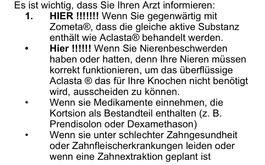

Expected Result: The lists should be displayed correctly with enumeration characters and appropriate indentation, as shown in the attached screenshot expected_result.jpeg. Same Code still works as expected using XCode 15.x
Actual Result: The list is displayed without enumeration characters or indentation, which matches the attached screenshot actual_result.jpeg.
