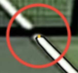

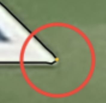

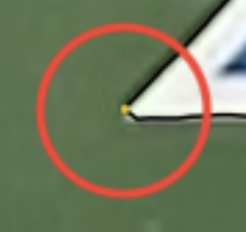

hello I got contour filtered. Should I ask this here or make a new question? still contour related. See pics. this zoomed in a lot. can we somehow get contours to be more, or contour the contour more accurately? or less contours might help and thus detect corners more? or any method to detach corners or lines better and accurately please? :) note: the black line is the contour, not the circle.
