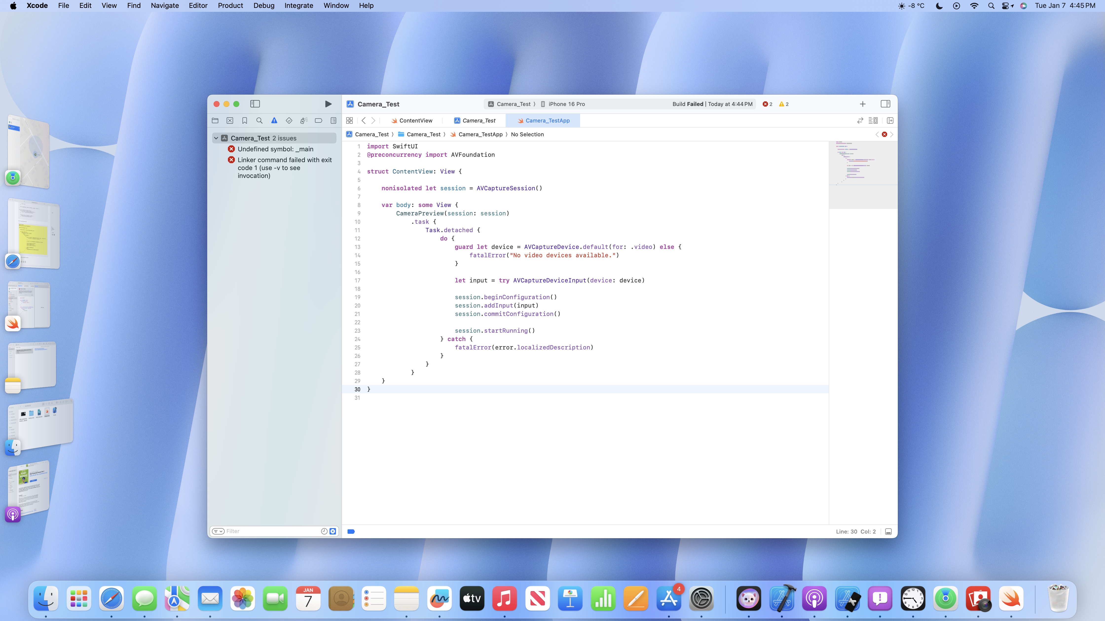

Hi Greg, Thank you for your time. I followed your code, but I ran into some issues. Sincerely, Oliver
Hello Oliver,
That error is telling you that your app is missing a top-level entry point. For SwiftUI, that usually means you are missing an App declaration with @main, for example:
@main
struct MyApp: App {
    var body: some Scene {
        WindowGroup {
            ContentView()
-- Greg
