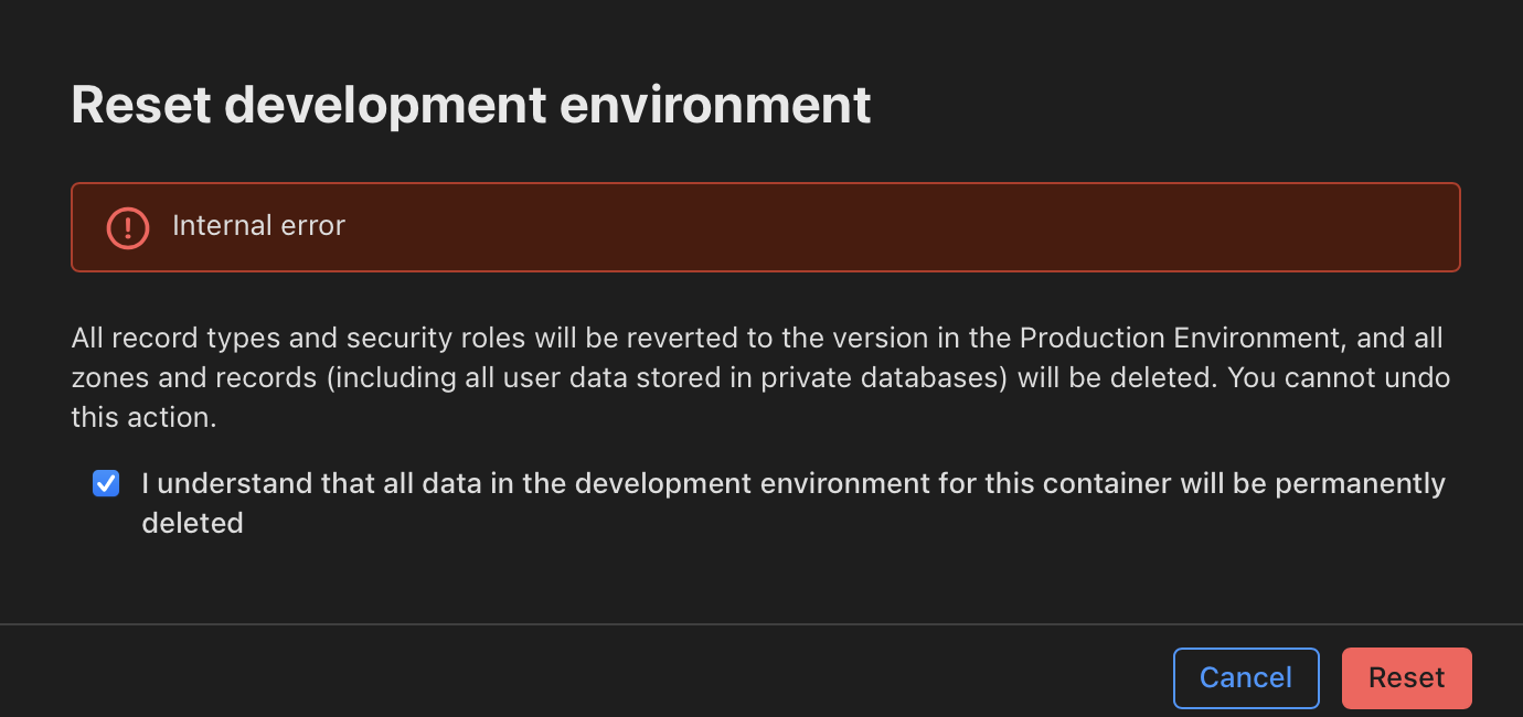

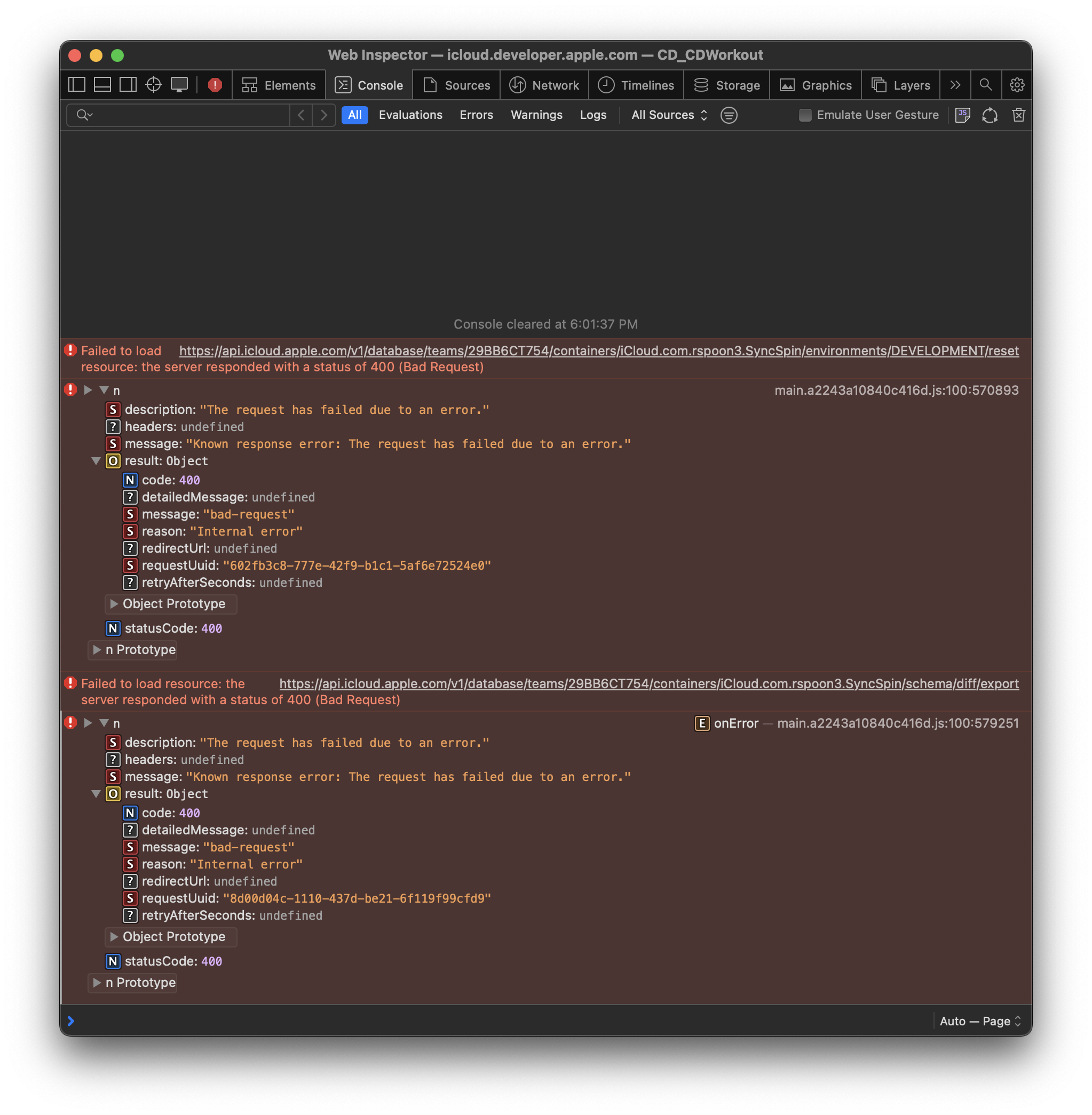

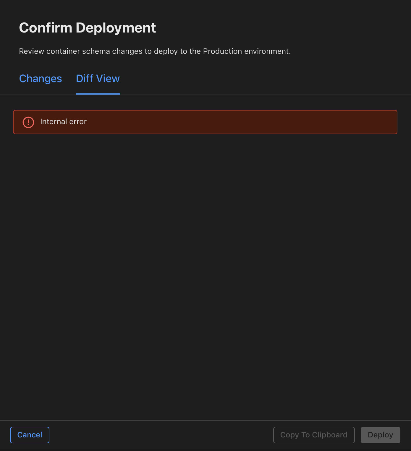

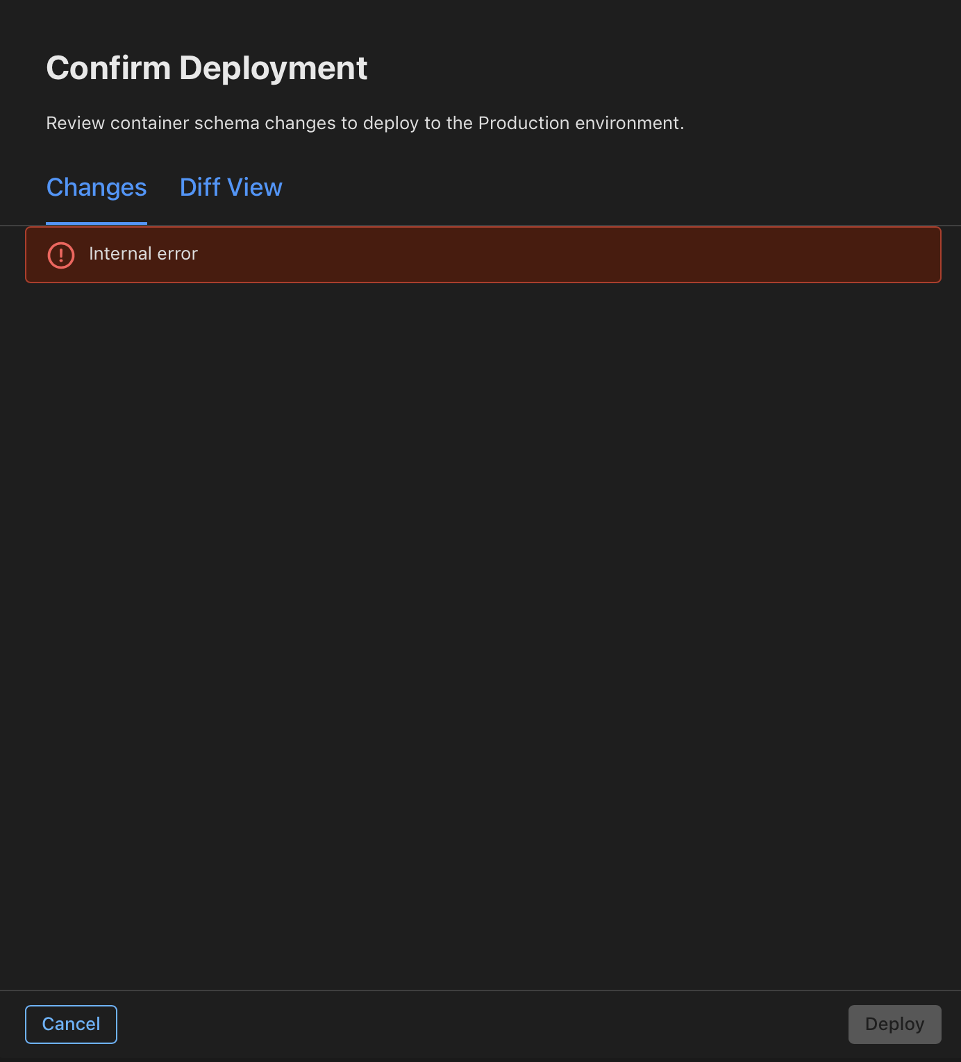

I have integrated CloudKit into a CoreData application and am ready to deploy the schema to production but keep getting an "internal error" when trying to deploy to production or reset my CloudKit environment. I have attached images of what I am seeing including one of the console error. Is there any way to resolve this?
Answered by DTS Engineer in 819758022
Since the error happens in CloudKit Console, and is nothing related to your code, I'd suggest that you file a feedback report for the CloudKit Console folks to investigate – If you do so, please share your report ID here for folks to track.
For a workaround, if you create and use a brand new CloudKit container, will the error still happen? If not, it may be that the old container ran into a bad situation, and you can continue your development with the new container.
If a new container doesn't work either, I'd be wondering if something in your CloudKit schema triggers the issue. I don't know how complicated your schema is, but for debugging purpose, you can start with a simpler schema that can be successfully deployed, and then incrementally add new record types or fields to eventually figure out what triggers the issue.

I tried a few days later and although it first appeared to give me the same issues, after a few browser refreshes the environment was able to be reset. After that I was able to push the schema was able to production after a few more refreshes.
Seems like it was just something on the CloudKit backend. I don't believe it was schema related as I only had two basic objects. It was also happening with a new CloudKit Container.
That indeed sounds like a CloudKit bug then.
