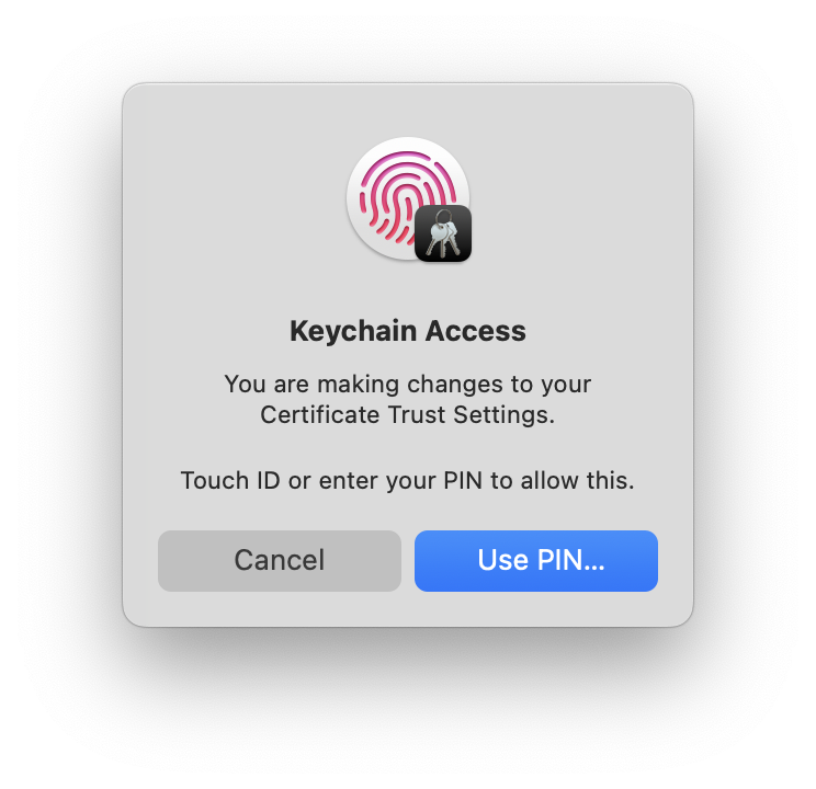

I noticed that the Keychain Access utility uses exactly what I am looking for if I delete something from the Keychain. Please see the attached screenshot. Any idea if this can be done using Local Authentication?
I noticed that the Keychain Access utility uses exactly what I am looking for …
That UI is being presented by Authorization Services. Here’s how you can replicate it with your code:

Unfortunately that didn’t pan out.
I talked to the Local Authentication (LA) team about this and they confirmed there’s no supported way for LA to present the Use PIN button that Keychain Access presents via Authorization Services. LA has some support for smart card PINs, but this represents a gap in that support.
We’d welcome an enhancement request for this feature. I encourage you to file that, with details about your specific use case.
