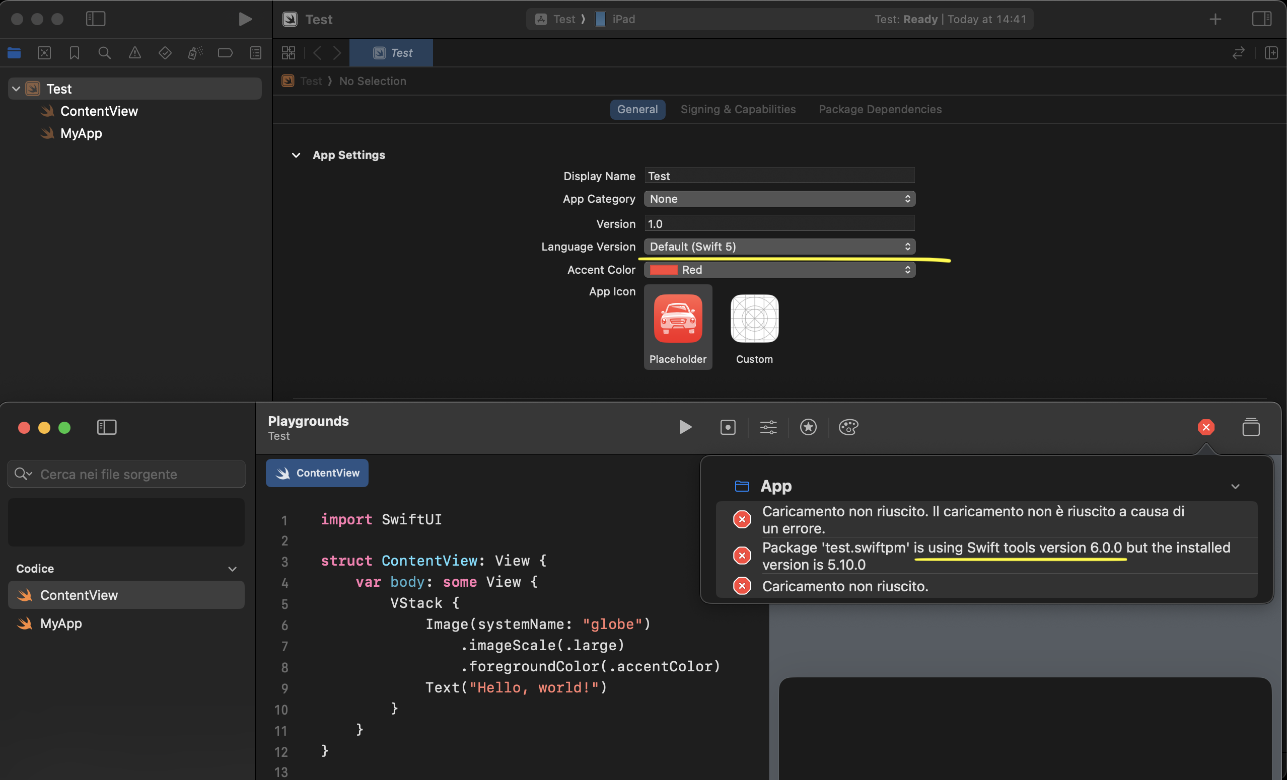

I'm facing an issue with Swift Playgrounds and files created in Xcode 16. It seems that Swift Playgrounds does not support Swift 6, but even when I create files specifically with Swift 5, Swift Playgrounds still reports that the files are unsupported.
This creates a significant problem because macOS Sequoia does not allow me to revert to Xcode 15, which might have offered better compatibility. As it stands, I can't find a solution to work seamlessly between Xcode and Swift Playgrounds.
Has anyone else encountered this issue? Are there any workarounds or updates planned to address this compatibility gap? Any advice would be greatly appreciated!
