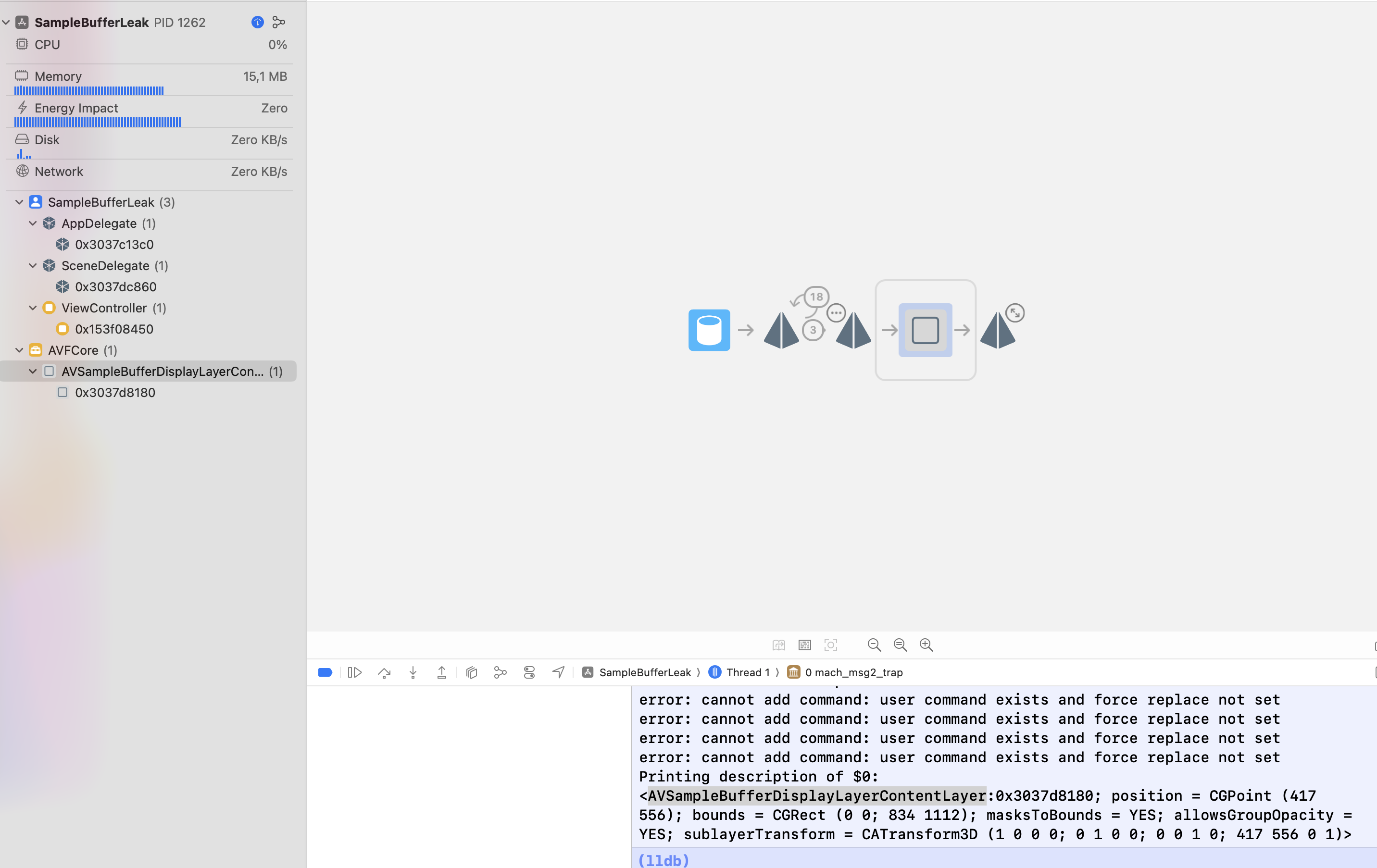

I noticed that AVSampleBufferDisplayLayerContentLayer is not released when the AVSampleBufferDisplayLayer is removed and released. It is possible to reproduce the issue with the simple code:

In my real project I have mutliple AVSampleBufferDisplayLayer created and removed in different view controllers, this is problematic because the amount of leaked AVSampleBufferDisplayLayerContentLayer keeps increasing. I wonder that maybe I should use a pool of AVSampleBufferDisplayLayer and reuse them, however I'm slightly afraid that this can also lead to strange bugs. Edit: It doesn't cause leaks on iOS 18 device but leaks on iPad Pro, iOS 17.5.1

I am experiencing the same issue, works fine in iOS 18, but not on iOS 17.7 apparently, both tested with physical devices. Tried the code in your post and I can also reproduce the same thing there, same issue I see on my other app.
@DTS Engineer Sorry, I haven't get notified about your reply. Here's link to the sample project that reproduced the issue.
https://github.com/standinga/SampleBufferLeak
