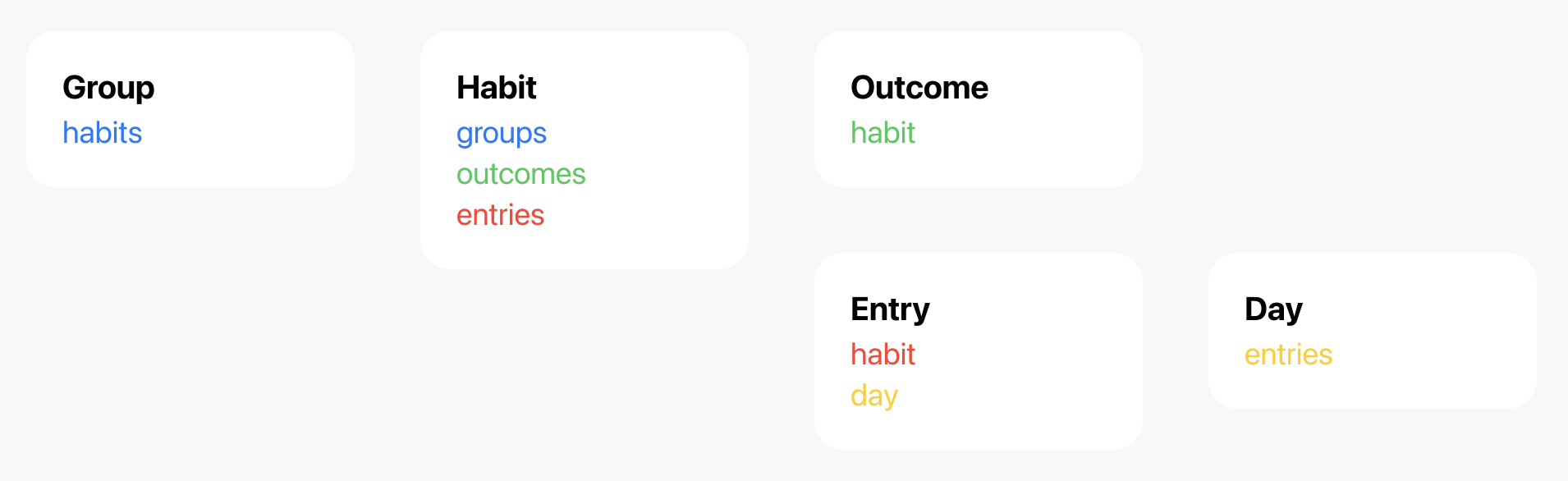

My database schema (image below) has relationships - "1 to many" and "many to many" - so it's convenient to use SwiftData (and underlying CoreData).
