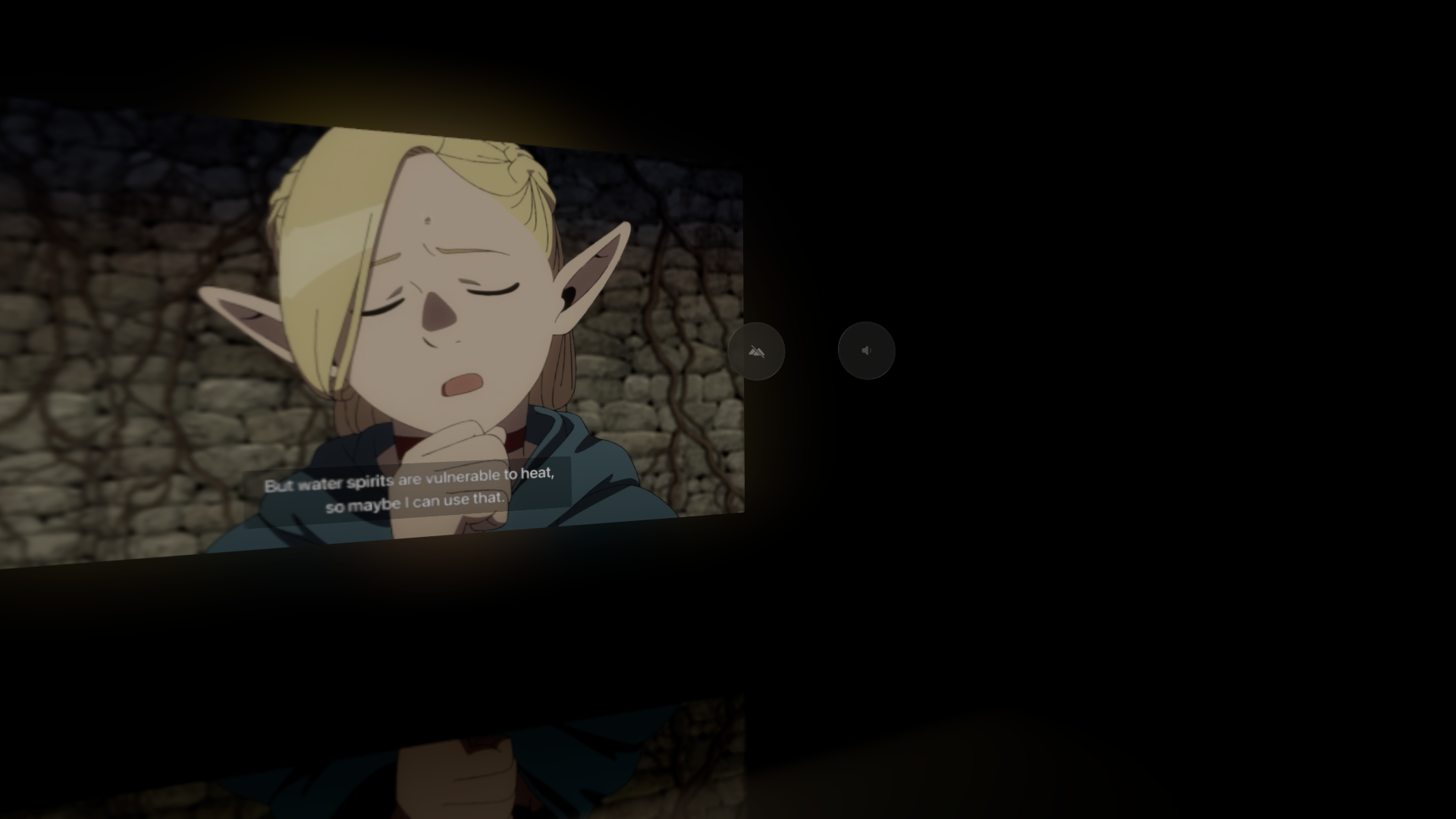

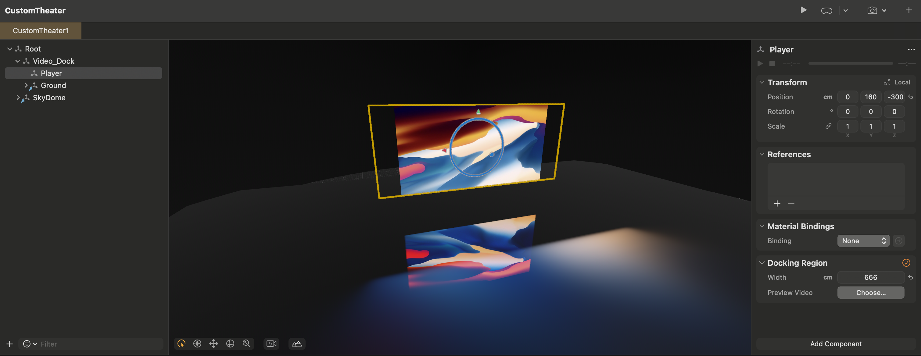

Hi, I added DockingRegion to my scene from Reality Composer Pro, and I am able to load up the scene, but DockingRegion is getting ignored and the scene is getting rendered with no change in AVPlayerViewController window. As it can be seen in Reality Composer Pro screenshot below, I set the width of the player to 666, and moved it to the back by 300cm, but the actual result does not reflect the position I set on Reality Composer Pro. Is there anything else I should do other than loading up the Entity and adding to RealityView? Specifically, do I have to get the DockingRegion within the usda file and somehow enable it?

Yes, the environment I am entering is a usda file, in which I added Video Dock using Reality Composer Pro. and I used immersiveEnvironmentPicker modifier on my AVPlayerView, a simple wrapper for AVPlayerViewController.
