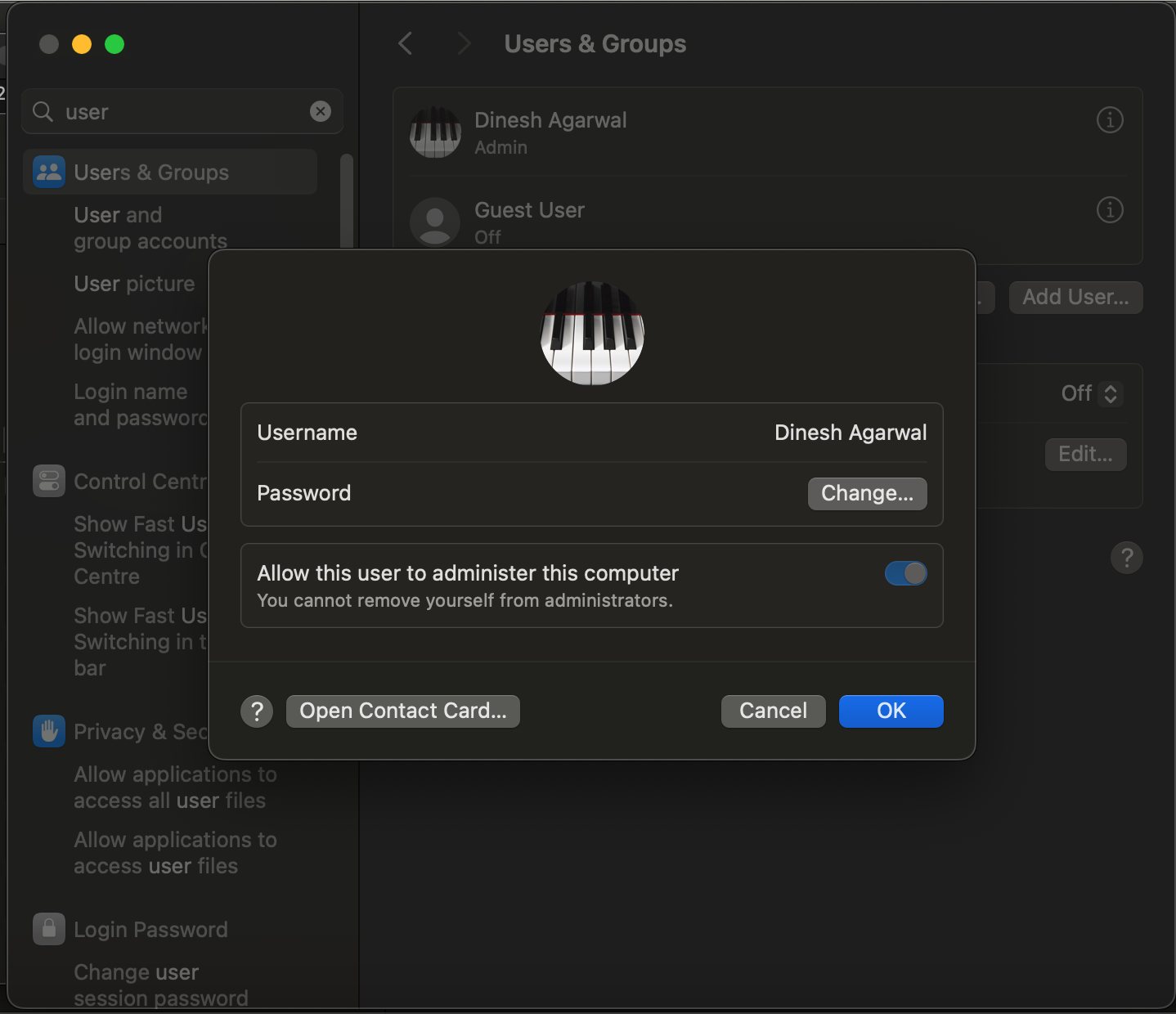

The Issue with this is that if someone changes the password, I want to show the password field again so that the user can enter his new password, but I cannot verify whether the stored password is correct.
Changes their password how?
This matters because, depending on where the password changing code is, you might be able to have it store the info you need to recognise this case. Critically, you’re going to want to store the password itself securely, because you could store a password generation number in a less secure, and hence more accessible, place.
Currently I am trying to change the password from the User and group tab in the settings.
In the Future might connect to the AD also.
I don't think I can track if some changes their password.
OK.
In this case I think you can deal with this by adding a ‘did try this password’ property to the authorisation hints. Set it in the mechanism that tries the password and clear it in your post-builtin:authenticate authenticate mechanism. If your main mechanism runs and the flag is set, you know you didn’t make it to post-builtin:authenticate mechanism and thus it’s likely that the password is wrong.
