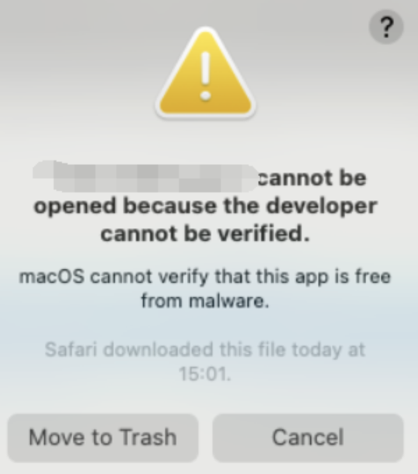

I am working on releasing my macOS arm64 app. My problem is that after the user downloads the dmg, double-clicking my.app in the dmg, a Gatekeeper pop-up box will appear with a warning that the developer cannot be verified.

  6. I completed the above steps and distributed the dmg. When I downloaded the dmg as a user test and double-clicked my.app in it, the Gatekeeper pop-up box still appeared, and the developer cannot be verified.❌
