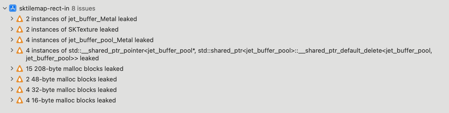

I looked deeper into what is happening, and what I see in the memory graph, is that for every present of the scene that is done, there are 3 SKTexture instances being created that are never released. The first time the scene is rendered, there 11 SKTexture instances allocated (I dont know why there are 11 though. I would expect 10: the source texture and the 9 tile textures).
But then as mentioned, after a tap and a new present, I get 14 SKTexture, of which 3 are zombies, see image leak_1.
Moreover, Xcode reports multiple additional leaks from Jet and Metal allocations, see image leak_all.
As far as I know, the code presented is not retaining any references that it should not, and I suspect this leaks are happening somewhere inside SpriteKit. But I am not able to find exactly where, or how to resolve it.
I hope someone can help with this issue.
Here are all the leaks reported by Xcode after a new instance of the scene is presented:
