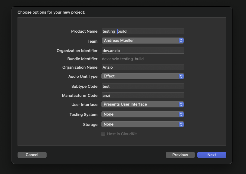

I have a similar problem. Just trying to develop an AUv3 extension. My own development worked well, but when i switched from Debug builds to Release or Archive, both fail with the same Swift Compiler Error, as mentioned above.
I then tried to just compile the default AUV3 effect project template with these settings in Release or Archive mode:
And it fails as well. Building only works in Debug mode. All builds had the Macbook as the target platform. No simulator or external device.
I am using the latest Xcode 16.2 on an M1 Macbook with Sequoia 15.2.
This is the error log:
Please submit a bug report (https://swift.org/contributing/#reporting-bugs) and include the crash backtrace.
Stack dump without symbol names (ensure you have llvm-symbolizer in your PATH or set the environment var `LLVM_SYMBOLIZER_PATH` to point to it):
Rename failed: /Users/anz/Library/Developer/Xcode/DerivedData/testing_build-fdofkvyzbyrzwfcisfoadodybwrs/Build/Intermediates.noindex/ArchiveIntermediates/testing_build/IntermediateBuildFilesPath/testing_build.build/Release/testing_buildExtension.build/Objects-normal/arm64/Parameters-a6d3ca7d.o.tmp -> /Users/anz/Library/Developer/Xcode/DerivedData/testing_build-fdofkvyzbyrzwfcisfoadodybwrs/Build/Intermediates.noindex/ArchiveIntermediates/testing_build/IntermediateBuildFilesPath/testing_build.build/Release/testing_buildExtension.build/Objects-normal/arm64/Parameters.o: No such file or directory
Rename failed: /Users/anz/Library/Developer/Xcode/DerivedData/testing_build-fdofkvyzbyrzwfcisfoadodybwrs/Build/Intermediates.noindex/ArchiveIntermediates/testing_build/IntermediateBuildFilesPath/testing_build.build/Release/testing_buildExtension.build/Objects-normal/arm64/ObservableAUParameter-ee5a1ee7.o.tmp -> /Users/anz/Library/Developer/Xcode/DerivedData/testing_build-fdofkvyzbyrzwfcisfoadodybwrs/Build/Intermediates.noindex/ArchiveIntermediates/testing_build/IntermediateBuildFilesPath/testing_build.build/Release/testing_buildExtension.build/Objects-normal/arm64/ObservableAUParameter.o: No such file or directory
