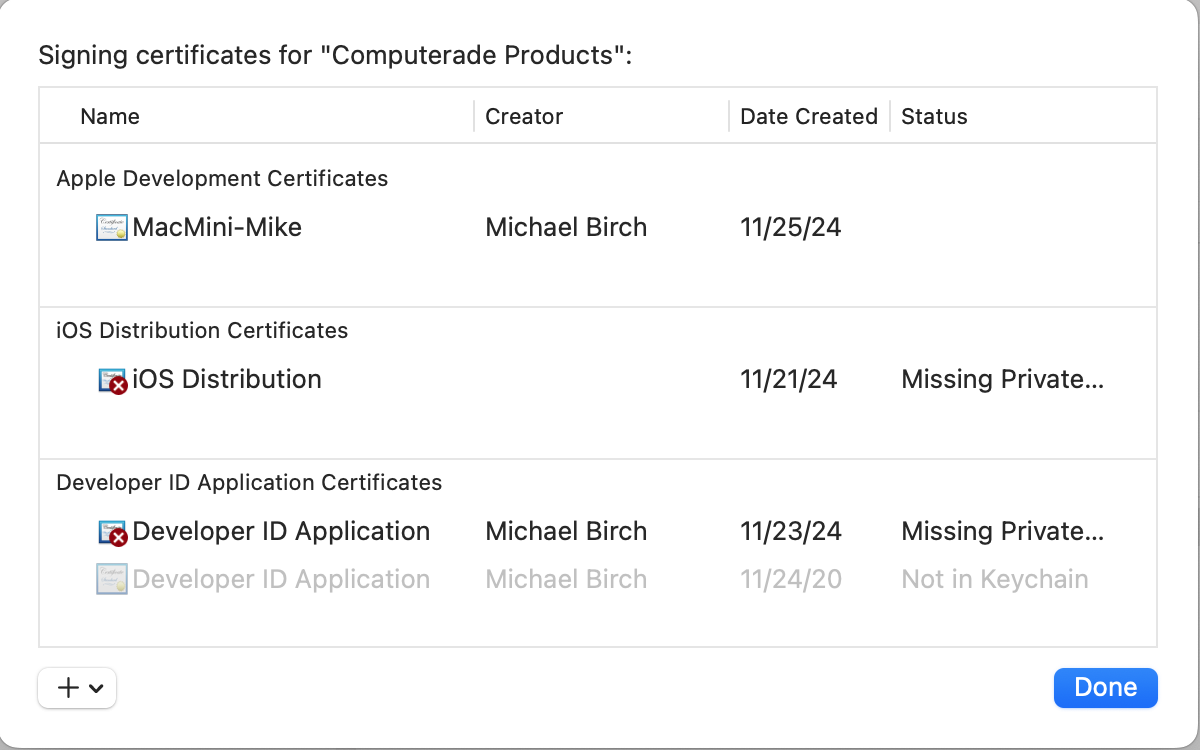

When I check the status of my account and select team I see "missing private key". Apparently it did not transfer over to my new Mac from my old Mac. R

I verified that Automatic signing is set. I am the one-man team as Computerade Products and the popup image is attached below -showing missing private key - although the certificates appear to be new (i.e. created on my new Mac).
My Test-App project Run is OK but Archive gives the same message that started this post. I'm on xCode 16.1.
