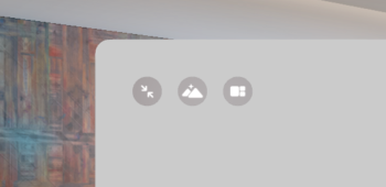

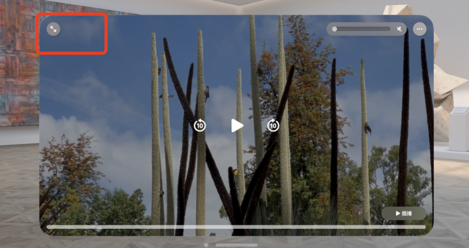

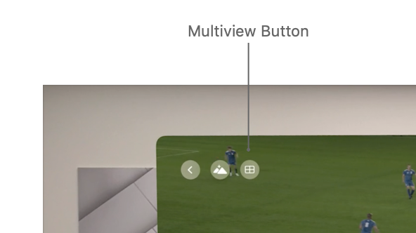

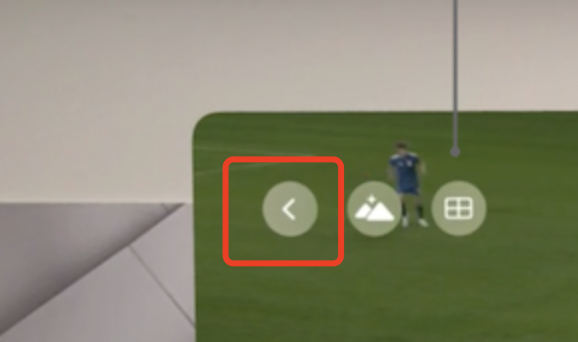

I want this kind of display
The effect shown now
hi Apple
I want this back button, but because mutileView is set, this back button is gone, there are only full screen and zoom out buttons, and I can't operate the playback page back
