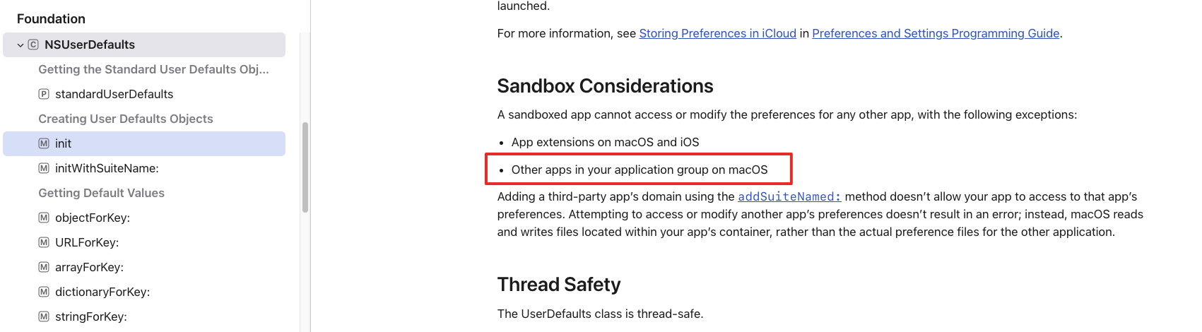

I try to use NSUserDefaults to share some parameter values ​​between the container app and the system extension. I have added the App Group in Signing & Capabilities in both apps. I set it in the container app and read it in the system extension app, but the information I read from the system extension is nil. I tested that I can read the information directly from the container app. Is the system extension running in the sandbox not allowed to read other app information? But the information I see should be OK, as shown below:
That won’t work. For an explanation as to why, and what you can do about it, see this post.
