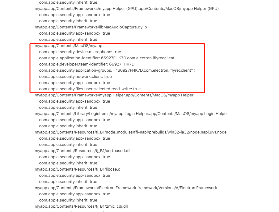

I tried using a third-party app (Pacivist) to open the app in pkg, nd export the app locally,then followed your instructions to perform the following actions:
1、 Run codesign against the results app to confirm that its signature is valid:
% codesign --verify -vvv /path/to/your.app
The results obtained:
PS:I noticed an error message
IFlytek heard. app: a sealed resource is missing or invalid File missing:/Users/pploo2/Desktop/icon/1/iFlytek heard. app/Contents/Resources/tj_S1/_MACOSX/ node_modules
I don't know if this is the key to the problem ITMS-90926.
2. Run codesign again to check that you have App Sandbox enabled:
% codesign --display --entitlements - /path/to/your.app
You can see that there is sandbox=true here

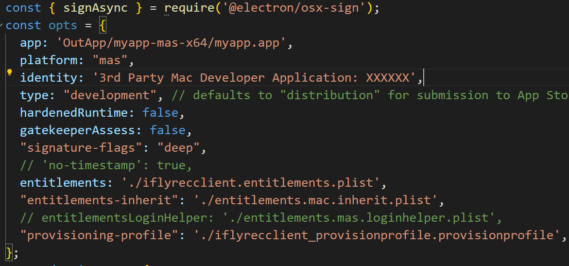

The reason for this issue is that when using @ electron/osx sign for signing, some parameters in the old option were invalid, resulting in the execution of the default entitlement. plist file in the node_module package.

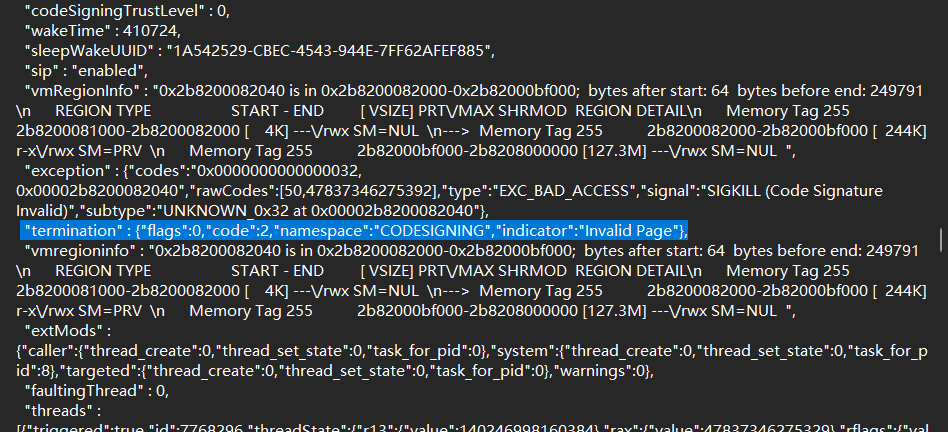

Then I checked my crash log and found that it may still be related to the signature
This is the complete crash log file
Then this is the entitlement file I used to sign, where the entitlement. mas file is used for signing the main program, and the entitlement. mac. other file is used for signing other internal executable files.
I use @ electron/osx sign to sign
Thanks. This is a classic hardened runtime incompatibility crash. I talk about these in Resolving Hardened Runtime Incompatibilities, part of my Resolving Trusted Execution Problems series.
It seems that the code hitting this is inside your third-party runtime. Usually you can resolve such crashes by signing the code with one of the hardened runtime exception entitlements. I can’t offer advice as to which one is appropriate in this case; you’ll need to ask that via the support channel for your chosen runtime.
I have read the link article you provided, and I understand that my problem may be due to some missing entities in the configured entities file. If so, is there a tool to check which entities should be provided? This project includes many modules, and I am not sure what specific entities are needed
No, because the answer depends on what your code does. Let’s consider two common cases:
  • If your code implements a JIT using modern techniques — that is, MAP_JIT — then you you need com.apple.security.cs.allow-jit.
  • OTOH, if your code hasn’t been updated recently, you need com.apple.security.cs.allow-unsigned-executable-memory.
You need to either understand how this code works or talk to someone who does.
